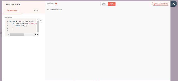

Selecting a single item using functionItem
I want to select the item containing a particular string, e.g. I want to select the UserName for “john”, from the json.
json:
    "UserName": "john.marshall@gmail.com",
    "Password": "Xyz-123"
    "UserName": "kevin.mosby@gmail.com",
    "UserName": "trevor.grills@gmail.com",
The code that i have written, when executed returns no text data found, while I am returning an item.
Code:
for (var i = 0; i < item.length; i++) {
    if (item[i].UserName.toLowerCase().includes("john")) {
        return item[i];
It looks like you are using a Function Item-Node when you should be using a Function-Node instead. You can find the documentation about it here which describes the difference and how both work:
