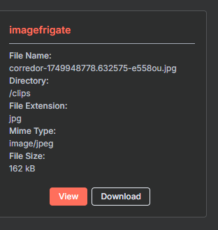

I run a self-hosted n8n v1.9x.
The Read/Write Files from Disk node reads a JPEG just fine (I can preview/download it in the execution). But when I try to push that same file straight into an HTTP Request node (to open-wa),
it sends a 3kbs file with the image name, but it is not a valid image.
$binary.image.data is always undefined, so the payload ends up like:
Docs don’t show how to grab the real file content directly.

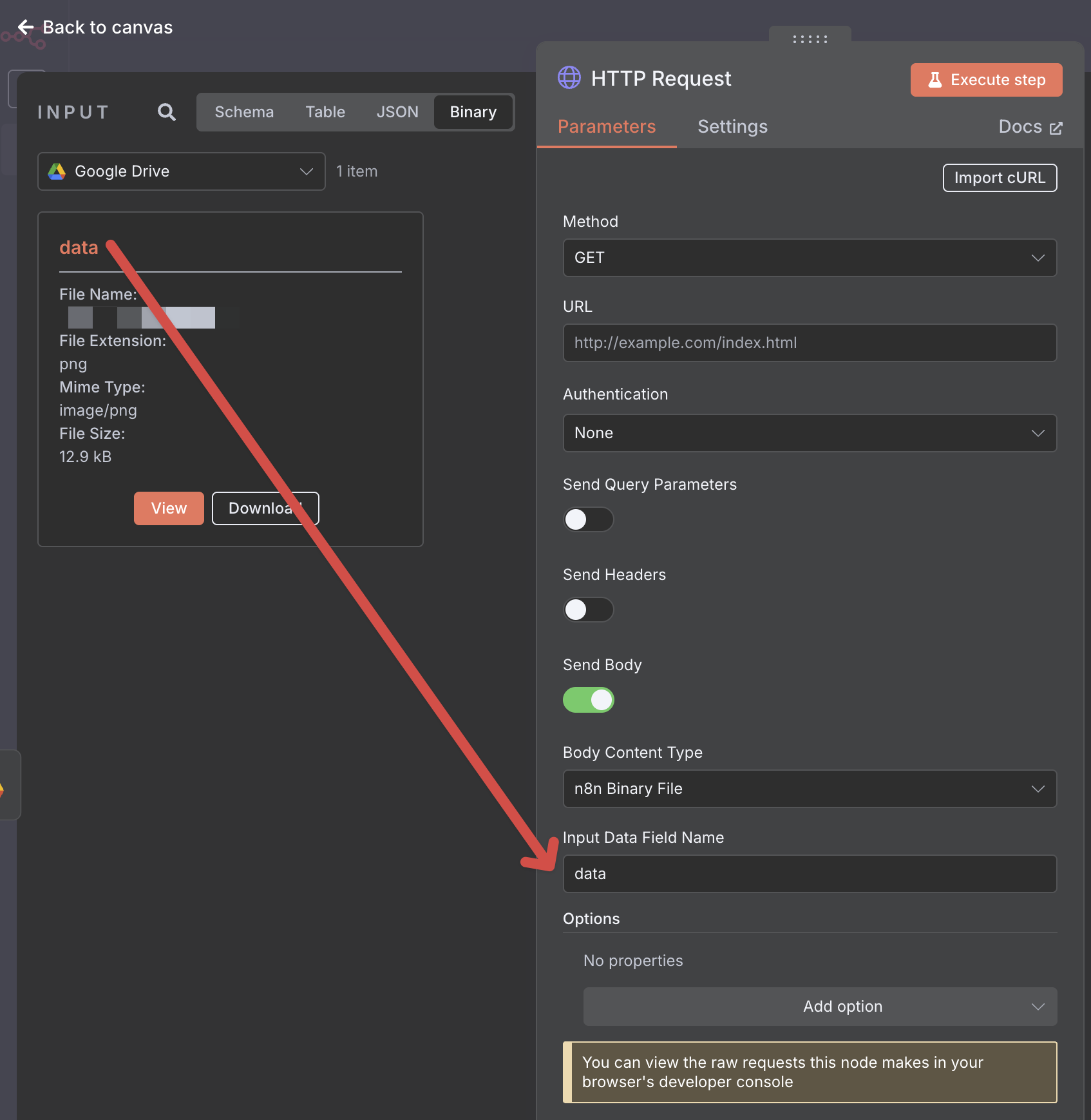

Thanks @darrell_tw
This opens up the understanding a bit more.
But I still haven’t managed to do it, I’m in the post method.
If I use send n8n binary or as Form-Data, with the file field using n8n binary file.
It gives me;
