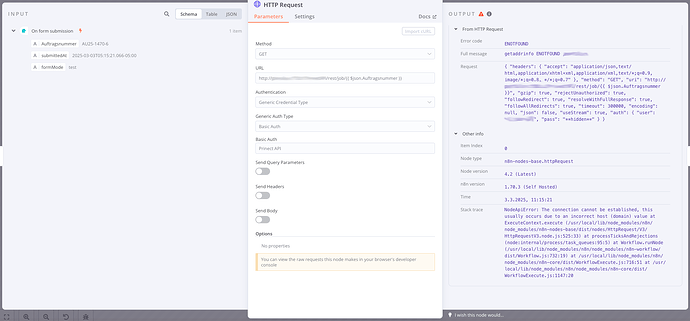

But my workflow is still having problems. I’m trying to send a GET-request to one of our servers. When i open the URL manually in my browser i can send the request for a job id for example and i will get the job id information. With n8n i want to send the job id via the form input as an expression in the request-url. The problem is, that the test doesn’t really respond. It’s still on “waiting for trigger event” even though i sent the form. When i look into the executions i can see, that the http-request cancels with the following message:
The connection cannot be established, this usually occurs due to an incorrect host (domain) value
ENOTFOUND
This also accurs when i try to trigger the request manually. It seems like i have configured my get request wrong, but i can’t find the problem.
