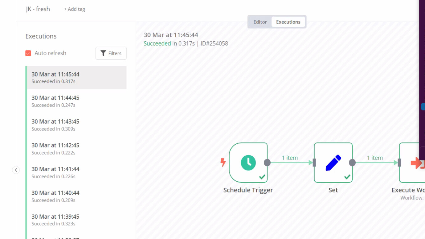

and I was looking at the execution details when I noticed this happen, when the execute starts running it showed local time, then when it completed it switched back to GMT…
As seen here …

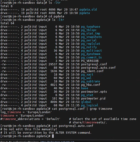

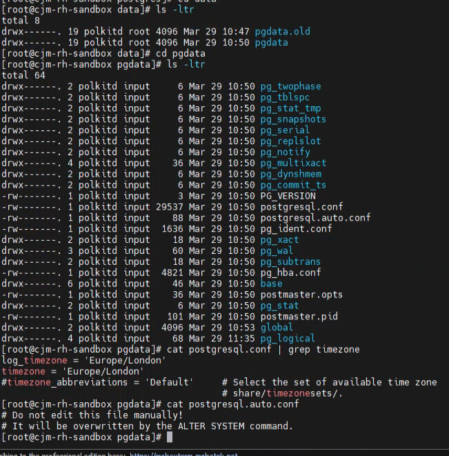

The N8N container is running in Europe/London, and even set PGTZ in the N8N container.
The Postgres DB was initialised on startup at 10:50:
The init-data.sh (DB reset) script was:

I’ve noticed … Subflow executions are showing the correct Timestamp ! While the calling Main Parent work flow shows does the strange Flip back to GMT when complete.
Parent:
Subflow:
