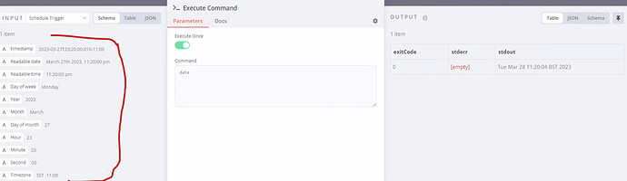

My test workflow:
That explains it, The main difference is that I set the TZ and Postgres time option for my Postgres container to Europe/London as well so it sorts itself out.
Ahhhh ok I need to find the ‘Postgres Time Option’ setting… as I’ve NOW set both N8N and Postgres TZ settings to TZ=Euope/London , Restarted both N8N and Postgres … but I’m seeing executing in 09:58, even though the schedule from the schedule node its saying 10:58… … I just need to find the Postgres Time Option.

Have even set the workflow to Pago-Pago timezone to see how bizarre this can get, execution still showing GMT, and the schedule node output showing the time for PagoPago

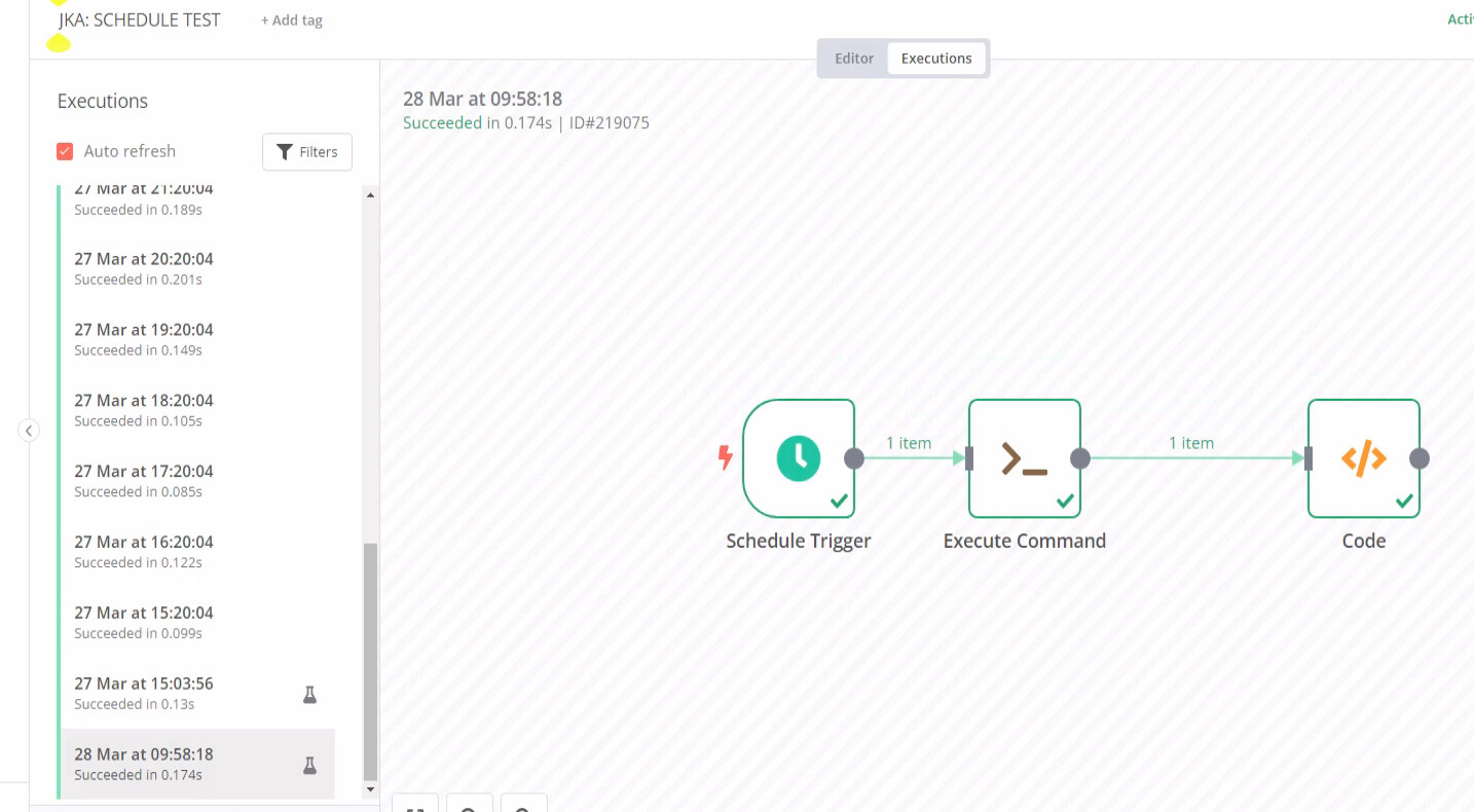

Grrrrrrr… I wish I could say that did fix it … but STILL no joy , Executions still showing an hour behind … even though have set the TZ , PGTZ , changed postgresql.conf , all to say Europe/London.
Have tried things around alter system , alter db using Europe/London …restart the N8N and postgres containers BUT Still N8N is showing the execution in GMT time 11:50 , when it’s now 12:50
