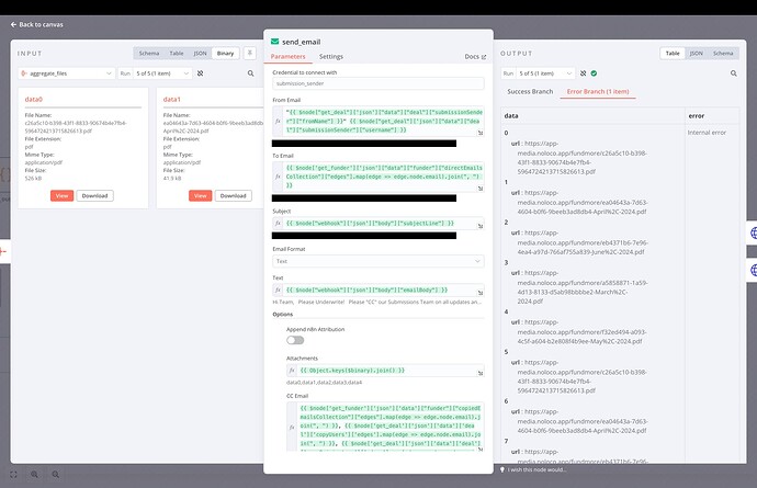

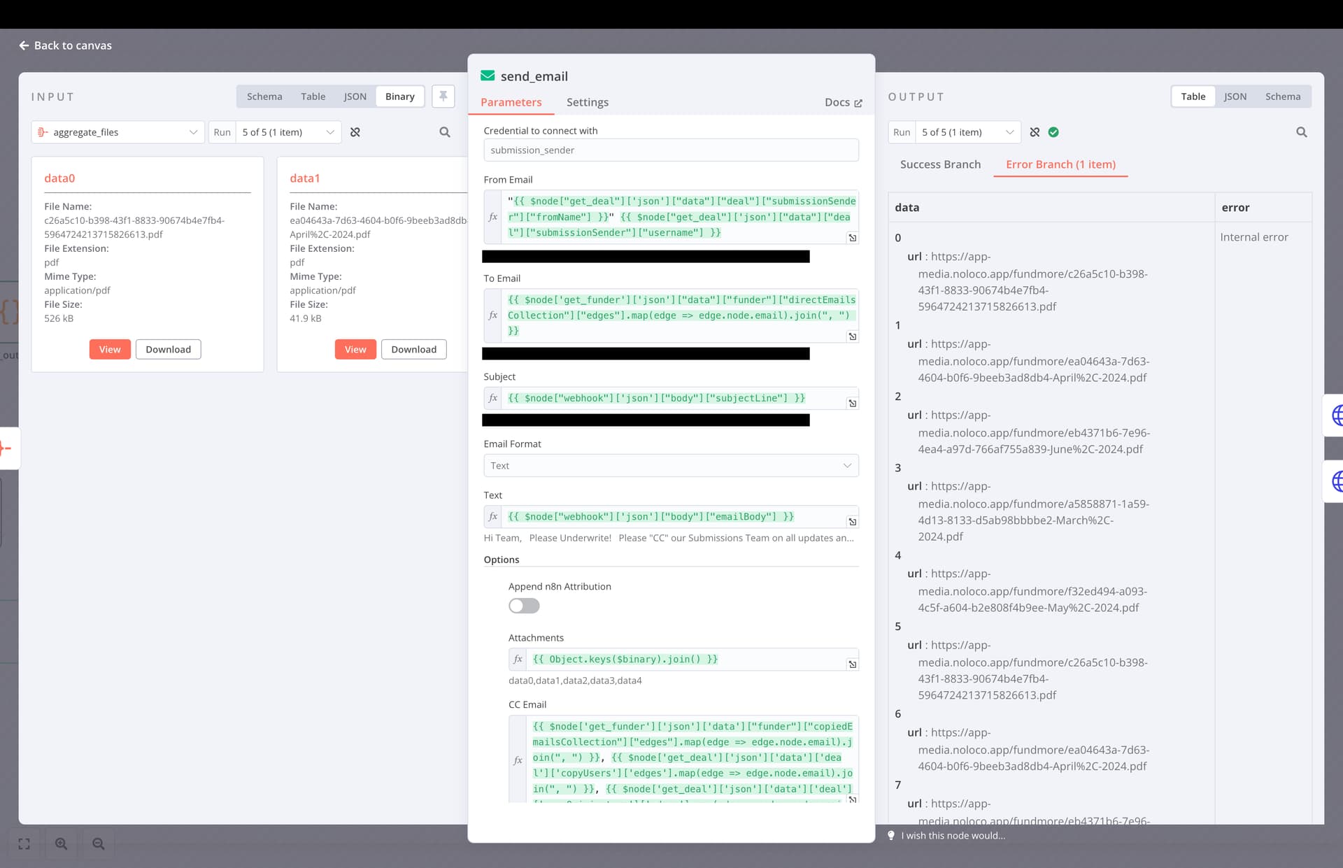

I’m getting random “Internal error” responses from the Send Email node, for no apparent reason.
There’s some talk online about it being an app passwords issue, but some emails are being sent correctly while others error — all using the same email credentials.
I’ve seen this error with Google Workspace, Outlook, and SMTP.com so I don’t think it’s an SMTP server-specific issue.
Should I try enabling “Ignore SSL issues” or that’s unrelated?
“Internal error”
“data”: [redacted],
“error”: “Internal error”

Is there a stack trace in the error at all that you can share? I suspect the issue is related to the connection settings but hopefully the trace show more.
Hi Jon, thanks for your input.
I’m not seeing a stack trace in the error (which is odd in itself).
By connection, do you mean credentials?
The thing is I doubt 3 different email providers would use the same exact error message, which makes me think it’s a frontend thing.
But I’m not an expert of course.
Hey @fundmore,

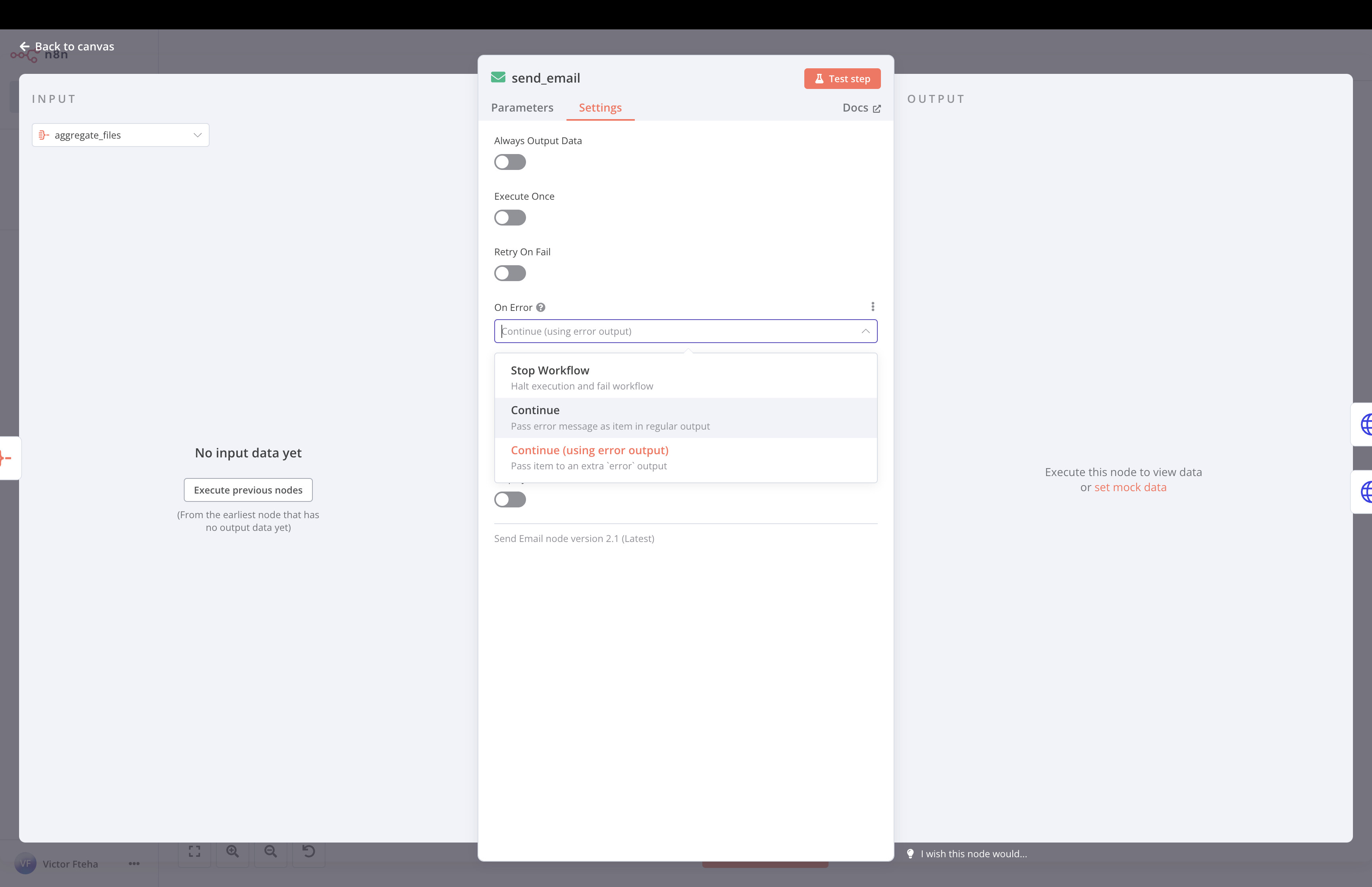

Can you turn off the error branch so you get the big error and that should have more information. We have a fix coming out in the next release which should reduce the number of the internal error messages.
I don’t think it is a front end issue based on it being “internal error” so I think it could just be mail provider settings which normally causes an issue.
I won’t be able to reproduce the error because the email account is not mine.
If I copy the errored execution to editor, and delete the error branch, will it show the big error?
And do I need to edit these settings:
Hey @fundmore,
You would need to set that to Stop Workflow then test the node but if you are not able to reproduce it we won’t be able to see the actual error.

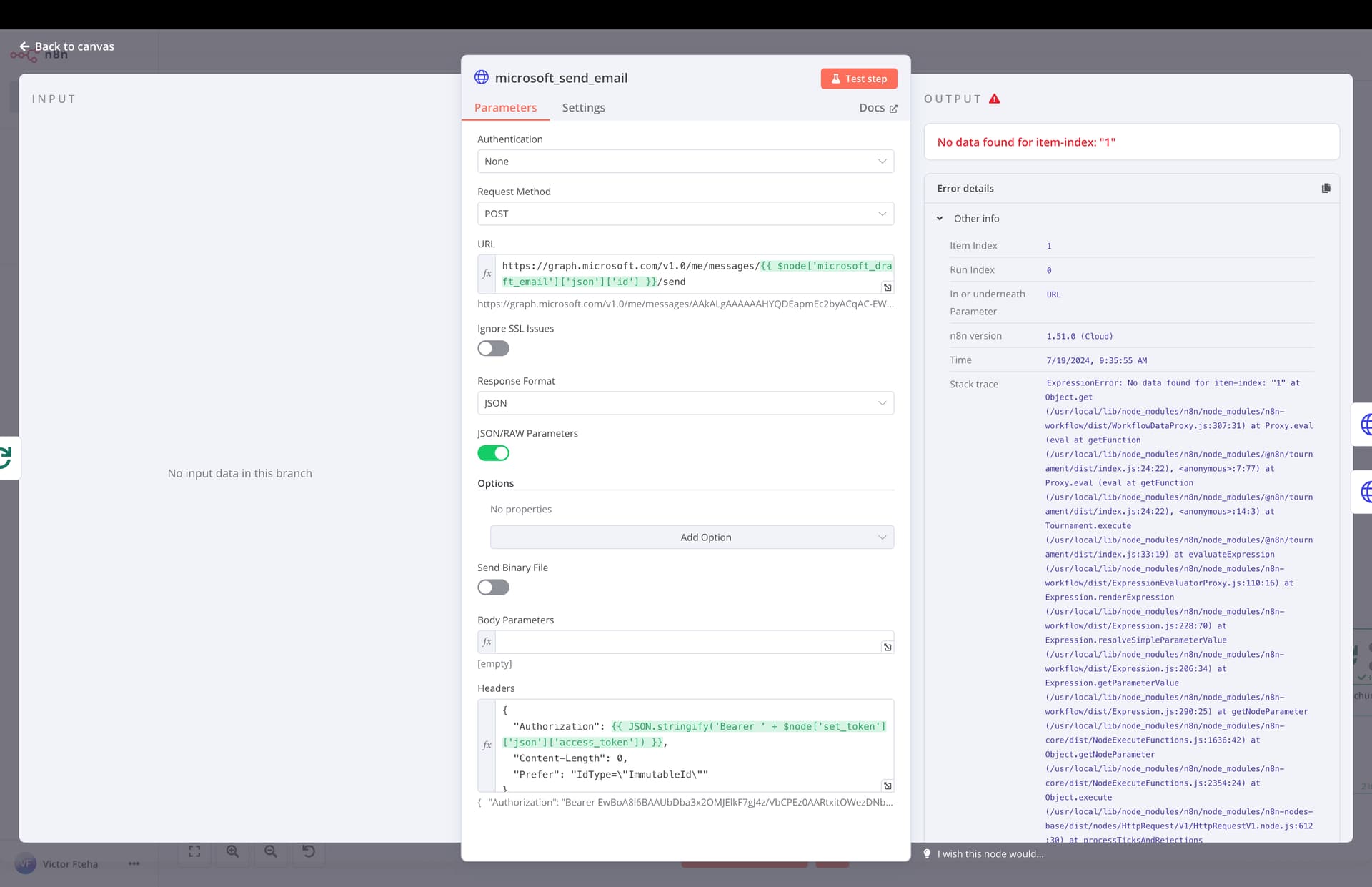

Now I’m getting a different error:
  "errorMessage": "No data found for item-index: \"1\"",
  "errorDetails": {},
  "n8nDetails": {
    "itemIndex": 1,
    "runIndex": 0,
    "parameter": "url",
    "time": "7/19/2024, 8:40:58 AM",
    "n8nVersion": "1.51.0 (Cloud)",
    "binaryDataMode": "filesystem",
    "stackTrace": [
      "ExpressionError: No data found for item-index: \"1\"",
      "    at Object.get (/usr/local/lib/node_modules/n8n/node_modules/n8n-workflow/dist/WorkflowDataProxy.js:307:31)",
      "    at Proxy.eval (eval at getFunction (/usr/local/lib/node_modules/n8n/node_modules/@n8n/tournament/dist/index.js:24:22), <anonymous>:7:77)",
      "    at Proxy.eval (eval at getFunction (/usr/local/lib/node_modules/n8n/node_modules/@n8n/tournament/dist/index.js:24:22), <anonymous>:14:3)",
      "    at Tournament.execute (/usr/local/lib/node_modules/n8n/node_modules/@n8n/tournament/dist/index.js:33:19)",
      "    at evaluateExpression (/usr/local/lib/node_modules/n8n/node_modules/n8n-workflow/dist/ExpressionEvaluatorProxy.js:110:16)",
      "    at Expression.renderExpression (/usr/local/lib/node_modules/n8n/node_modules/n8n-workflow/dist/Expression.js:228:70)",
      "    at Expression.resolveSimpleParameterValue (/usr/local/lib/node_modules/n8n/node_modules/n8n-workflow/dist/Expression.js:206:34)",
      "    at Expression.getParameterValue (/usr/local/lib/node_modules/n8n/node_modules/n8n-workflow/dist/Expression.js:290:25)",
      "    at getNodeParameter (/usr/local/lib/node_modules/n8n/node_modules/n8n-core/dist/NodeExecuteFunctions.js:1636:42)",
      "    at Object.getNodeParameter (/usr/local/lib/node_modules/n8n/node_modules/n8n-core/dist/NodeExecuteFunctions.js:2354:24)",
      "    at Object.execute (/usr/local/lib/node_modules/n8n/node_modules/n8n-nodes-base/dist/nodes/HttpRequest/V1/HttpRequestV1.node.js:612:30)",
      "    at processTicksAndRejections (node:internal/process/task_queues:95:5)",
      "    at Workflow.runNode (/usr/local/lib/node_modules/n8n/node_modules/n8n-workflow/dist/Workflow.js:728:19)",
      "    at /usr/local/lib/node_modules/n8n/node_modules/n8n-core/dist/WorkflowExecute.js:673:51",
      "    at /usr/local/lib/node_modules/n8n/node_modules/n8n-core/dist/WorkflowExecute.js:1085:20"
Does this mean no items were returned? Here’s the http request node that I’m using to send a draft email:
Hey @fundmore,
That is a lot better so that error means the second item in your input doesn’t have the field you are trying to use.
Thank you @Jon. That’s weird because I see both references show as green, and their values look correct. Plus the email went out so I don’t think the URL or access token could’ve been empty.
Hey @fundmore,
The referecnes will only show the first input item, In this case for some reason the node is running more than once and the second run can’t find the data from the node you are calling.
At a guess the aggregate node has more than one output.

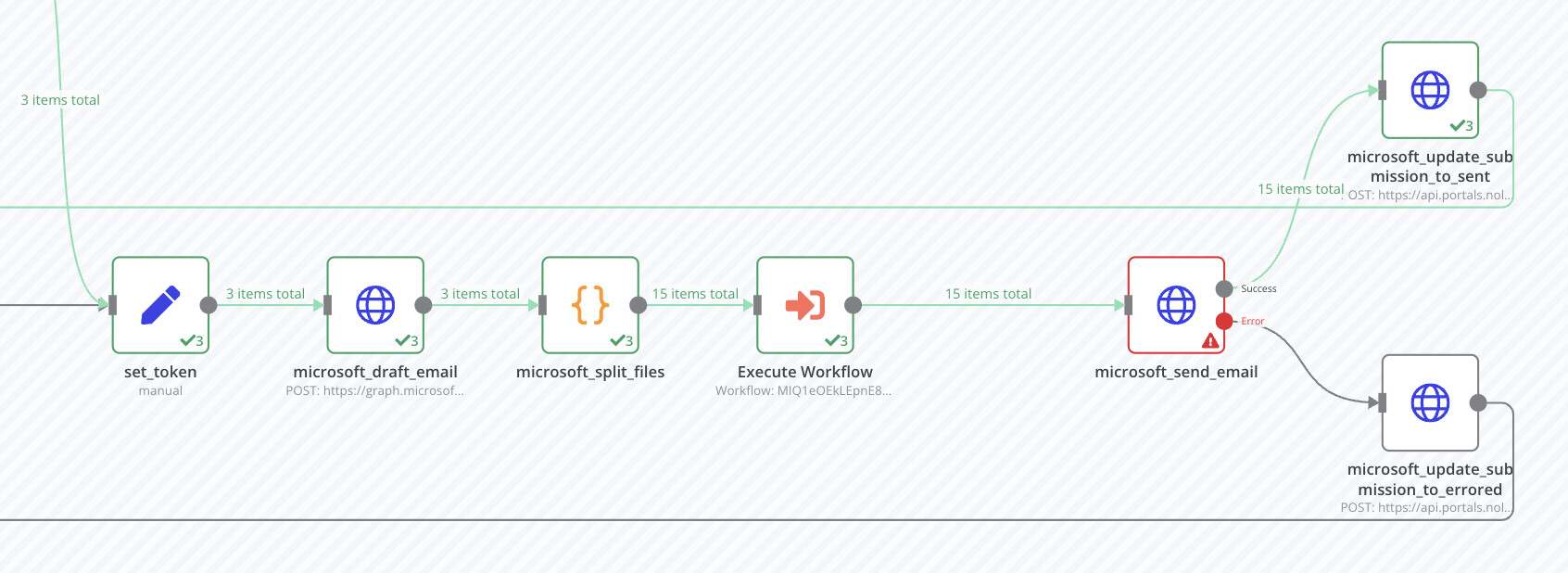

Hi @Jon, I know it’s been a while but I decided to continue working on this workflow and now I’m getting the same hidden error as before.
For context, I’m iterating over a list of funders ie. recipients. For each funder, I want to:
  • create a draft email via Microsoft Graph API
  • send an array of file URLs to a sub-workflow which adds them as attachments to the draft
  • send the previously created draft email
In this test run (screenshot attached), there were 3 funders and 5 files, which is why it says 15 items.
The UI shows “Internal error” (and “Retry On Fail” will run if enabled), but the email goes out correctly and the workflow follows the Success branch.
I’m now on version 1.57.0 self hosted. Thank you for your help.
