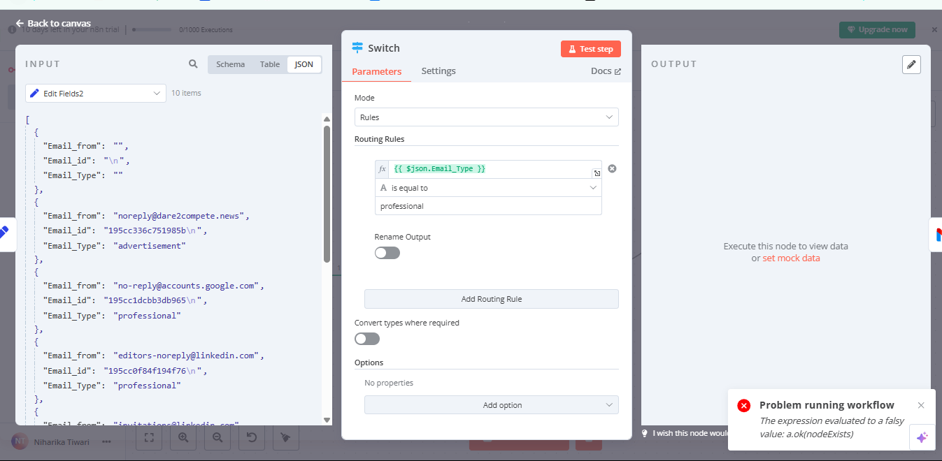

Send label through email
Why is this giving me error in switch my condition is i want if the email_type is professional then go further or else email_type is advertisment etc but its giving me error. What mistake i am doing?
Does it exist for all records?
Try putting using this expression:
{{ $json.Email_Type || “” }}
Do not expect this to be the issue, but is something to quickly try.
not working
i am giving same condition in if node its working but not in switch.
:thinking:
Not sure whats up here, I have never seen the error.
What version are you on?
now i have run the entire workflow its working!!!
Ok, so just some funkyness with running a partial workflow.
