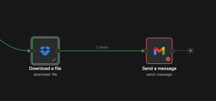

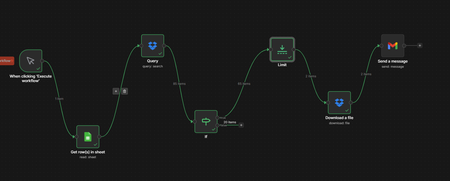

I had a dropbox node that return 2 items, i need to send one email with the two items that returned,

Heya @Mohamed_Hayder - please share/show the error that’s being reported, also would help to have a copy of your canvas code also.

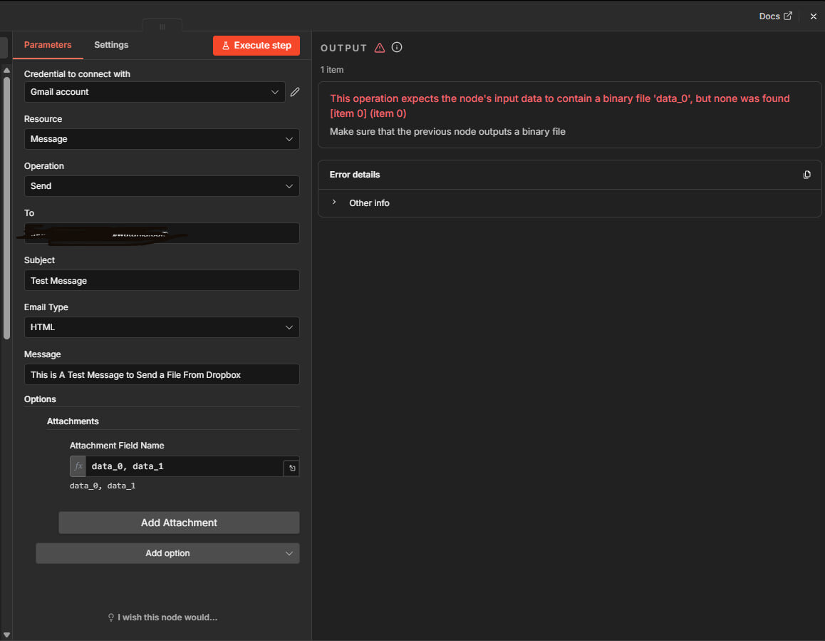

that a test scenario, it works clearly with no error, just the email sent two emails one for each item and i need to send them by one email both

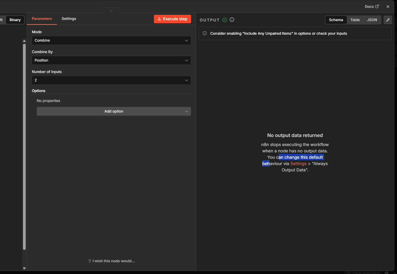

Have you tried using a merge node after that DropBox node and before gmail node? with Mode combined by position? and then in your gmail you can attach those files by {{ Object.keys($binary).join(',') }} so this would attach all binaries at once.
Hi @Mohamed_Hayder - go into node ‘send a message’ > Options > Attachments > and change field data to include the several files as strings seperated as commas > see reference to prior solution here - let us know how this goes for you and if any further assistance.
when i do that there is no output’s, and when enabling “include any inpaired items” stay 2 items output.
the gmail node refuse it.

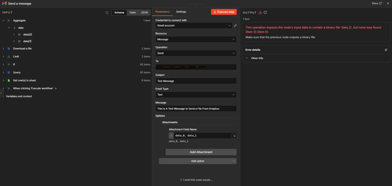

have a check for which attachment variables are available to call from on left pane - or please share the workflow code so I can replicate and perform correction.
thats the data that return from previous node, and when delete the aggregate node still the same error
if you can open the dropbox on left pane to show the varibles available for the files

@Mohamed_Hayder Understood try aggregate node for now that would surely work and set that to All item data with include binaries option enabled and then you can use this {{ Object.keys($binary).join(',') }} to attach files in your gmail.
THAT’S WORK, THANKS YOU SO MUCH, Appreciate you assistant.
