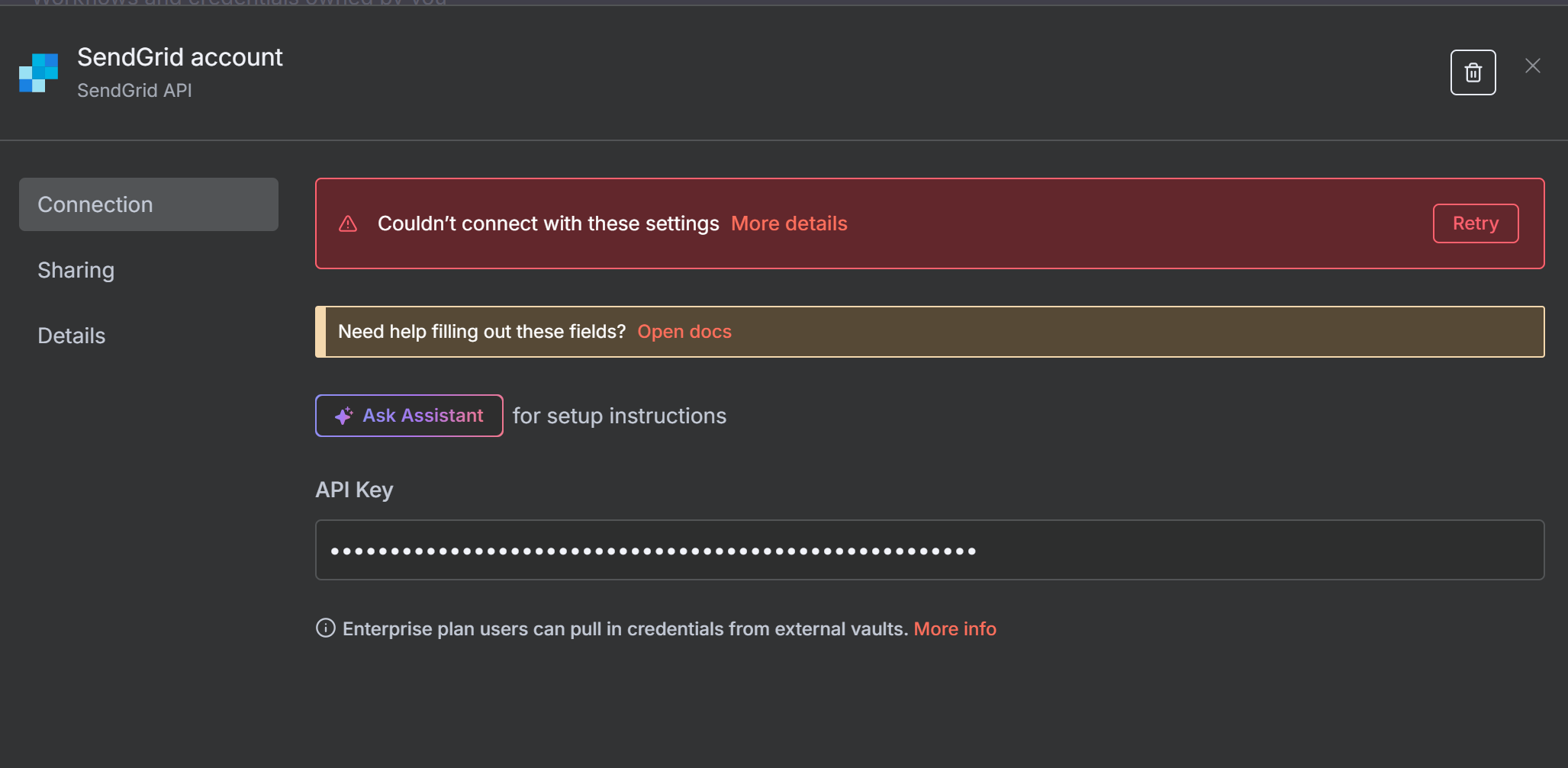

Today on my SendGrid nodes they showed this error…these were all working and now do not. I created new API keys with FULL Access still don’t work. I checked my SendGrid account is paid and active and no issues there. Any thoughts

Its strange these have been in place for months on multiple workflows. So I went into SendGrid made sure the account was in good standing. I have 100K limit and only send 6K this month so that is not it.
I created multiple new API keys with Full Access to troubleshoot and every key I create gets this message…I am at a loss and feel something change between N8N communication and SendGrid

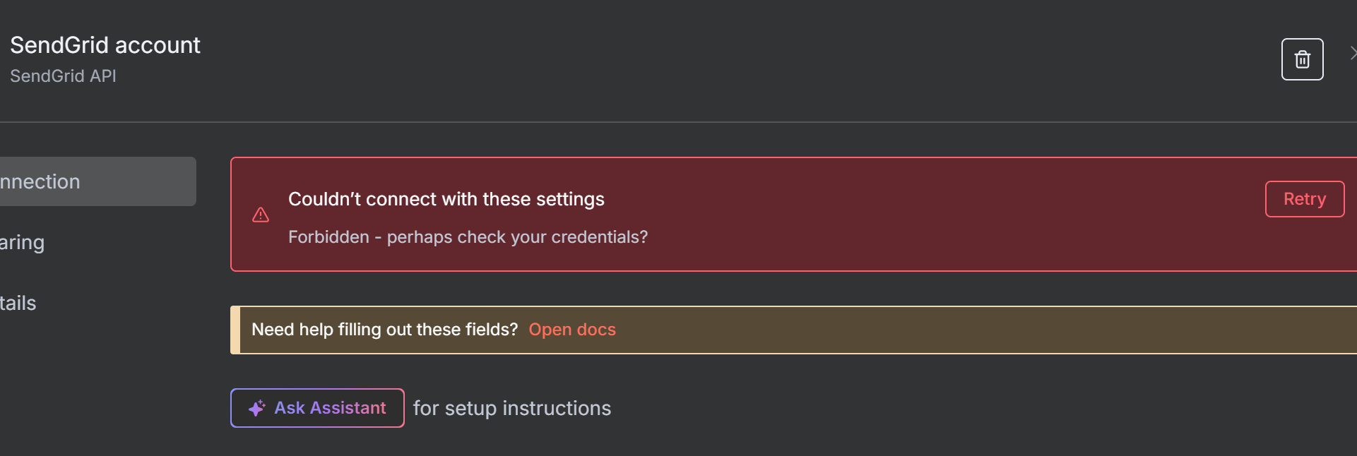

Forbidden means you have an issue with credentials. Maybe the token is not in the right format, or maybe you have copied some spaces/extra characters
Thanks I thought that but checked and I created at least a half dozen new keys to ensure each was new, full access.

I had this problem too. The API key doesn’t work with the node, so I moved to HTTP Request and it works well.
Eduardo thanks could you explain a little more not sure I follow how to setup
Well, you can’t say that it just doesn’t work. There is something that makes it work or not on sendgrid side for some. Works for me just fine on self-hosted 1.111.0.

I have the same issue, api key works fine, suddenly not anymore.
After some digging, I read in this thread that the Sendgrid node uses a marketing/contacts api endpoint to test if the api key works. Now i see in my account that i don’t have access to this module, so maybe that’s the issue? @Jon Is this still the case? Maybe there is another endpoint that can be used to test the api key?
