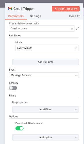

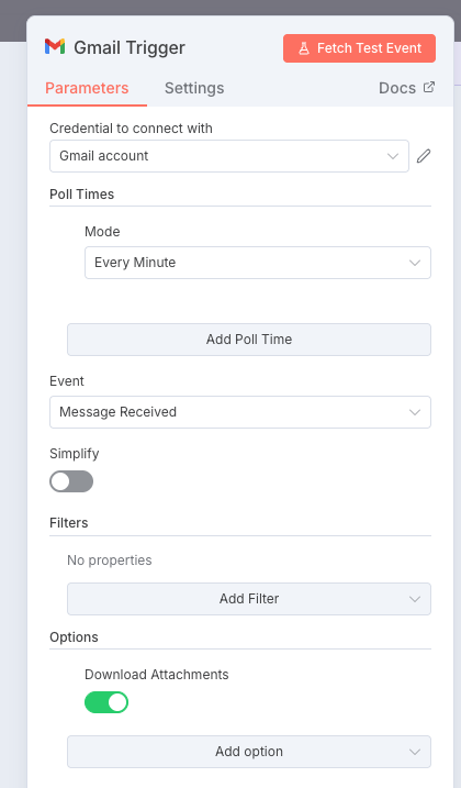

You can extract attachments from emails by configuring the Gmail Trigger like this:
  • toggle “Simplify” off
  • Add option “Download Attachments” and toggle it on

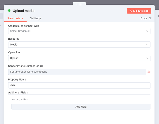

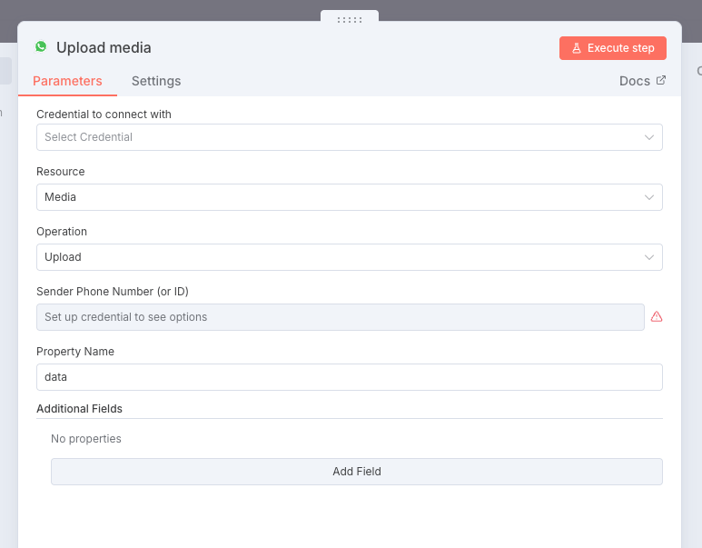

Unfortunately I don’t have access to WhatsApp Business, but I assume you need to use the “Upload Media” node:
