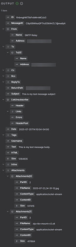

What I’m receiving the the “GetMessage” look like this :

Hum…
I’m not sure to understand. While doing test, I’ve moved to the “Aggregate” node, using the “Attachements” field.
But I can’t use this field… even if I select the Attachments[0], I’m still getting the split error.

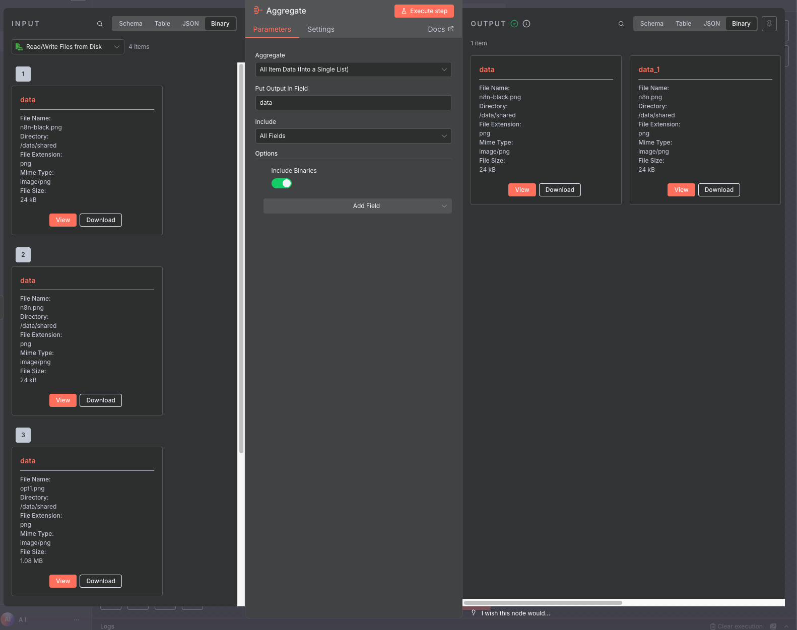

In aggregate there is an option for including binaries.
Also don’t aggregate based on the text field “Attachments”, aggregate actual binaries.
Here, see 4 items coming in, 1 coming out:

Oh, right… just found the option “include binary” !
Now I have the option to use {{ $binary }} in the attachment field, but still getting that “split function” error.
