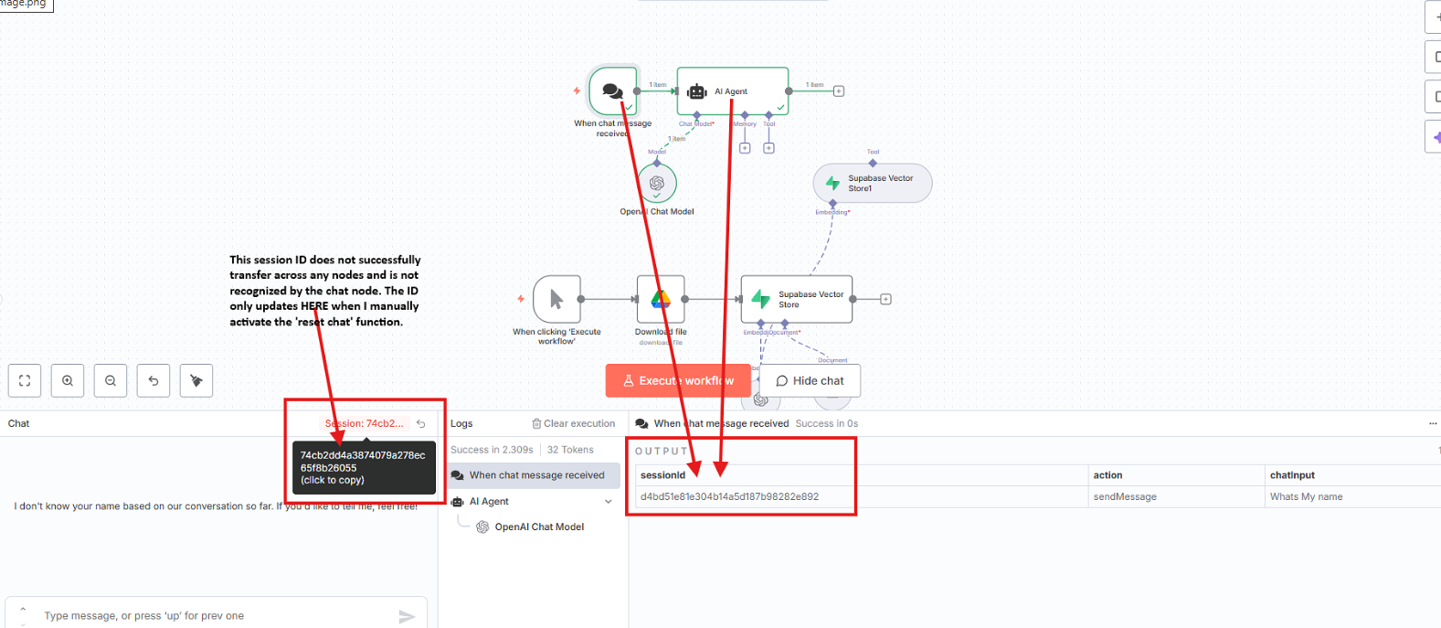

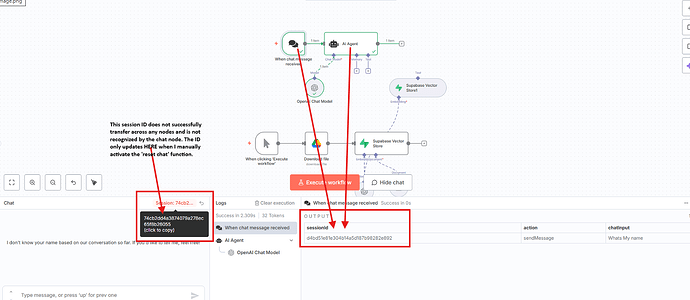

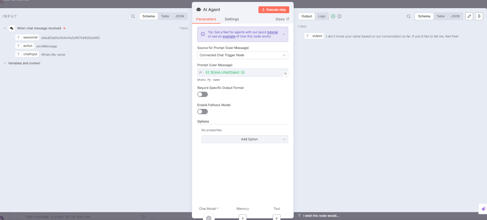

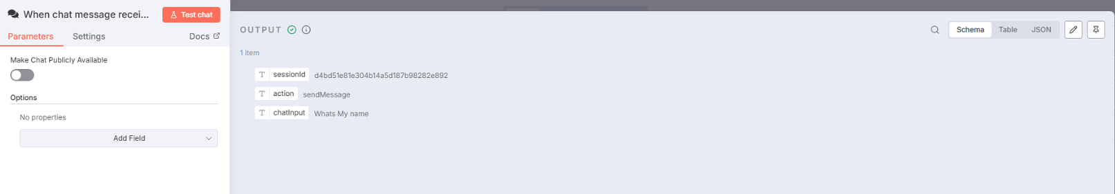

When I run Clear Session, I expect a new session ID. But the system keeps reusing the old one. The logging table, the Chat Trigger, and the AI Agent are all still writing messages under the original session ID instead of the new one.
Example:
Original session ID: d4bd51e81e304b14a5d187b98282e892
New session ID after reset: 74cb2dd438374079a278ec65f8b26055
Has anyone else had this happen or have ant ideas?
Theoutput is included in screenshot (AI Agent)

Yeah, I tried all the steps you mentioned. I also tested it by stripping the workflow down to just a Chat Trigger and an AI Agent with no Supabase or credentials, and the session ID issue still happens.
I mentioned this in a couple other n8n related communities too and they said the same thing. Nobody there has seen this happen before either. Before I file an actual bug report, I’m going to try making a completely new free n8n account under a different email and see if the issue follows. If it does, then I’ll report it.

I’m seeing the same behavior on mine. The session changes for the chat in UI, but the sessionId in the JSON passed from the chat input node to my AI Agent remains the same. I’m on version 1.122.5, latest version.
