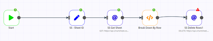

I have a set node that set’s a variable, and the following connected node get’s it just fine.
However, for nodes after a “function” node, I can no longer access the set variable, even if I call out the original node by name in the expression like this:
https://api.smartsheet.com/2.0/sheets/{{$node[“SS - Sheet ID”].json[“SheetID”]}}/rows?ids={{$json[“id”]}}&ignoreRowsNotFound=true
The problem value is:
It just returns a “” value instead of the sheet ID I set.

So interestingly, it doesn’t work for the earlier node, but that nomenclature works for the set node immediately preceeding the node the expression is in..
In the photo below, the SS - Sheet ID doesn’t come up as a valid expression value for node SS Delete Rows1, but SS - Sheet ID1 does.

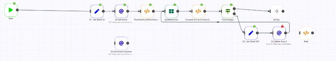

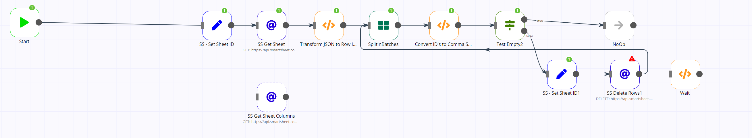

Here’s the workflow.
The basic idea is this:
  1. Get all the data from smartsheets
  2. Use the node “Transform JSON” to remove the upper-most level of irrelevant json, since I just need the column ID’s array.
    3- Split the column ID array into batches of 50 items, since the API call is passed that as a comma seperated list in the query header, limiting the number of ID’s that can be passed without breaking the header size. (Technically, I have been able to do up to 250, but with this sheet, it results in API timeouts due to the size, so I had to reduce it to batches of 50).
    4 - Use the “Convert ID’s” function to change the JSON array into a comma separated list.
    5 - Test the list to see if it’s nil (because then it’s done)
    6 - Use the Set Sheet ID1 node to re-set the sheet ID
    7 - Delete the batch of rows
    8 - repeat with next batch.
