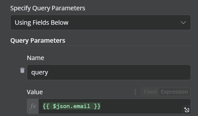

@hrishikesh In my use case, I need to search for an account ID in Jira using the email address submitted by users in a Google Sheet. How should I configure the “HTTP Request” node to enable the system to search for the account ID based on the provided email address?
Once you have connected the Google Sheet node to the HTTP request node, the data from Google Sheet node should be available to the HTTP request node in the “input” section. You should be able to use that data to dynamically craft the URL. My n8n instance is currently not loading, so I can’t show you an example at least right now, but hopefully that would give you an idea. If not, I can try putting an example together once it loads.

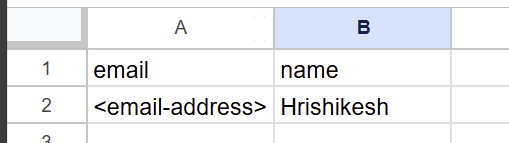

So assuming your sheet has something like:

where the query params would look like:

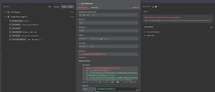

@hrishikesh I’ve set up the “HTTP request” node as you advised, but it seems to be causing an error with the Create JIRA Ticket node, as shown in the image below.
That error seems like your “summary” is missing. From the looks of the setup, I would guess that the summary didn’t exist in the row that was fetched from Google Sheets.

@hrishikesh, when I remove the “HTTP request”, the node from sheet to JIRA works normally. I assume that adding the “HTTP request” in the middle is causing the issue, as I’ve demonstrated above. Do you have any ideas on how to resolve this
@hrishikesh, I’ve resolved the issue by adding the “Google Sheet Trigger” node in the JSON description as below:
