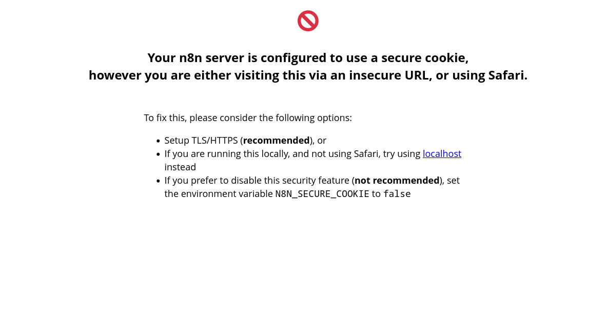

and it starts, but in browser I get
I’ve tried starting with inserting before npx
N8N_SECURE_COOKIE=false && npx n8n
but no change, but it obviously reads .env, as it starts on the on other interfaces.
What else I should do to get it working.
Or maybe how to make it work on https if that is obligatory for non local installs

hello @w3fans
in linux the env should be exported via command
export N8N_SECURE_COOKIE=false
without the export command you have only defined a local variable which npm doesn’t know
n8n doesn’t know of a file named .n8n/.env, and will not pick up these env variables from there.
Please let us know if you found these instructions in the docs somewhere, so that we can get the docs fixed.
Actually I just removed && and then it started to work.
TBH I don’t even know anymore, was using ChatGPT a lot looking documentation, search, forums. It’s very little written about modifying parameters when started as npx n8n. I didn’t realize it doesn’t pickup .env, it makes sense, as I was doing all possible changes and no luck.
BTW at the same time it was but inside to prevent adding new elements if not started by https…
But regardless I gave up and was able to install it via docker, and setup reverse proxy so I can connect directly from outside.
Thanks for your help
