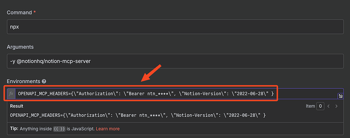

I’m trying to configure the Official Notion MCP server but having issues with credentials. I’m not sure how to properly set environment variables (I already have my ntn_… token created and used in the different ways I attached).
Could anyone clarify me the way I need to introduce/format env parameters?
Note: While this configuration works properly in Claude Desktop when set in the JSON, in n8n credentials appear to be different🤔.
Thanks in advance!

Hi all,
Below is the syntax for the env:
OPENAPI_MCP_HEADERS={“Authorization”:“Bearer ntn_********”, “Notion-Version”: “2022-06-28” }
Thank you
Best regards,
Steven
I have the same issue. After inserting the above environment in the credentials
(aka, after inserting:
^exactly like that)
It just changes it to __n8n_BLANK_VALUE_xxxxxxxxxxxxxxxxxxxxxxx
Then, when trying to execute the MCP ExecuteNode, it gives that the API Key is invalid and it cannot access it.
Tried literally everything I could think of, but not the faintest clue what’s going wrong or why it doesn’t work.
Anyone got some ideas or tips?
