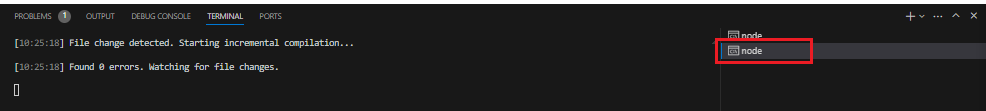

Hi,
Sorry but still not working.
In my node directory I run the commands as below, if I change something in my execute function I don’t get the expected results.
and then npm run dev
Hey @Igor_Barcelos,
The dev reload should only work when running n8n from source, If you are building your custom node outside of the n8n project it likely won’t work.
Personally when I am making community nodes I make it inside the n8n project then copy it out to publish it.
