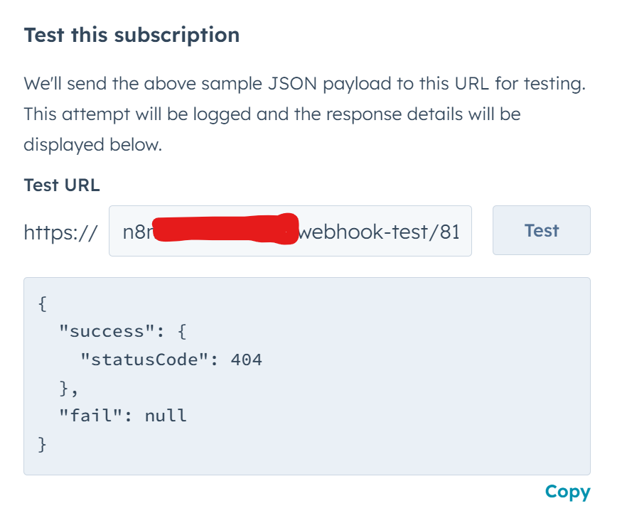

I have not been able to get webhooks working and I think it’s because I’m using docker.
Test platform hubspot webhook.

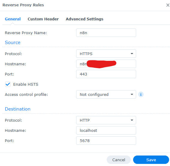

  • have reverse proxy set up, so n8n.domain accesses my n8n instance

If I make a webhook call to n8n.domain, then the router passes everything in :443 to synology:443. Synology will catch this in the reverse proxy and pass it to the docker at 5678. Then what does the docker see? Does it see it at port 5678 instead of 443 - is that the issue?

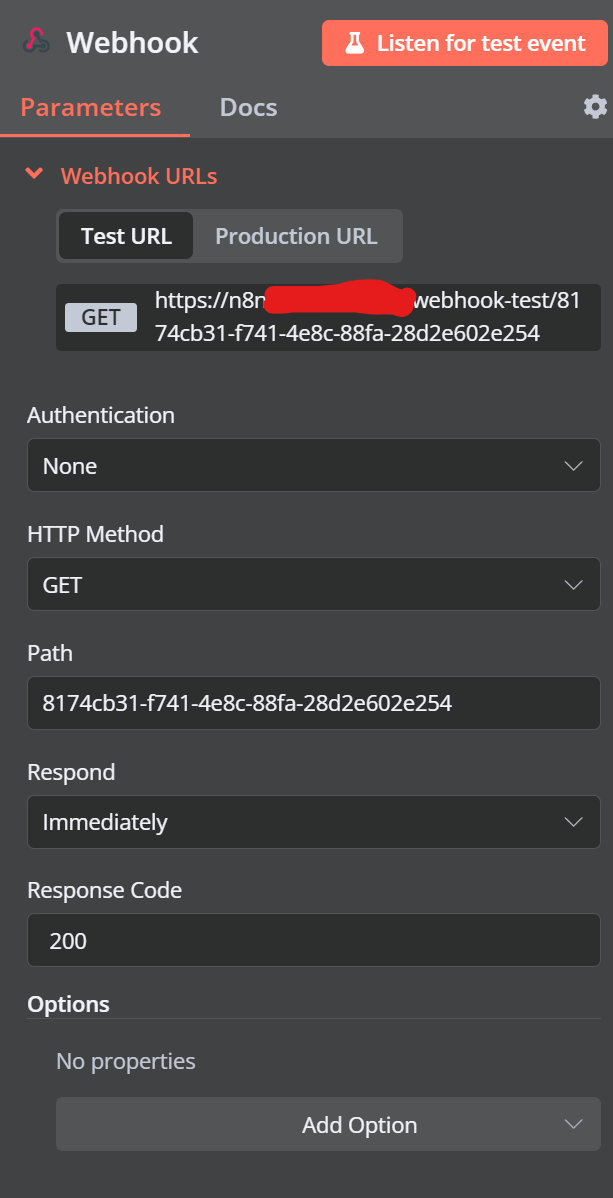

For example I’ve said this up
in n8n I used
