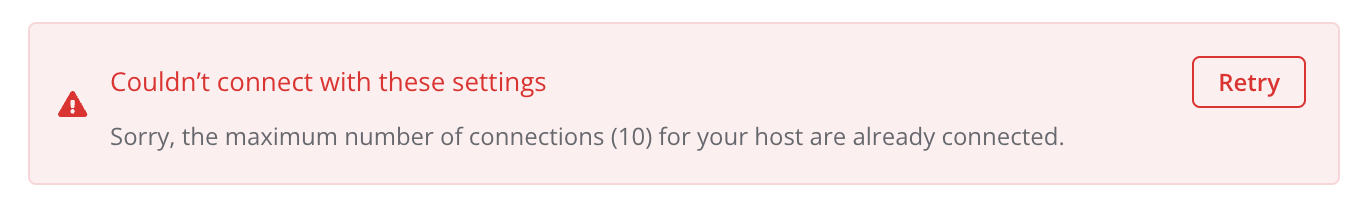

If I try to establish a new connection during this time, either via the credentials or the FTP node, I always get this error message:
Remote host has reset the connection: read ECONNRESET

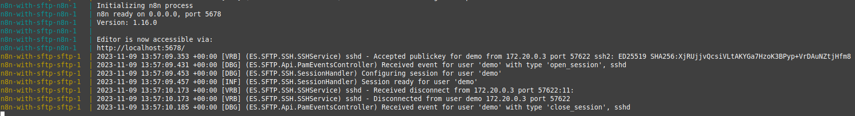

I just tried reproducing this behaviour with the below workflow:
However, n8n seems to close the connection as expected here:
This was using the below docker-compose.yml setup:

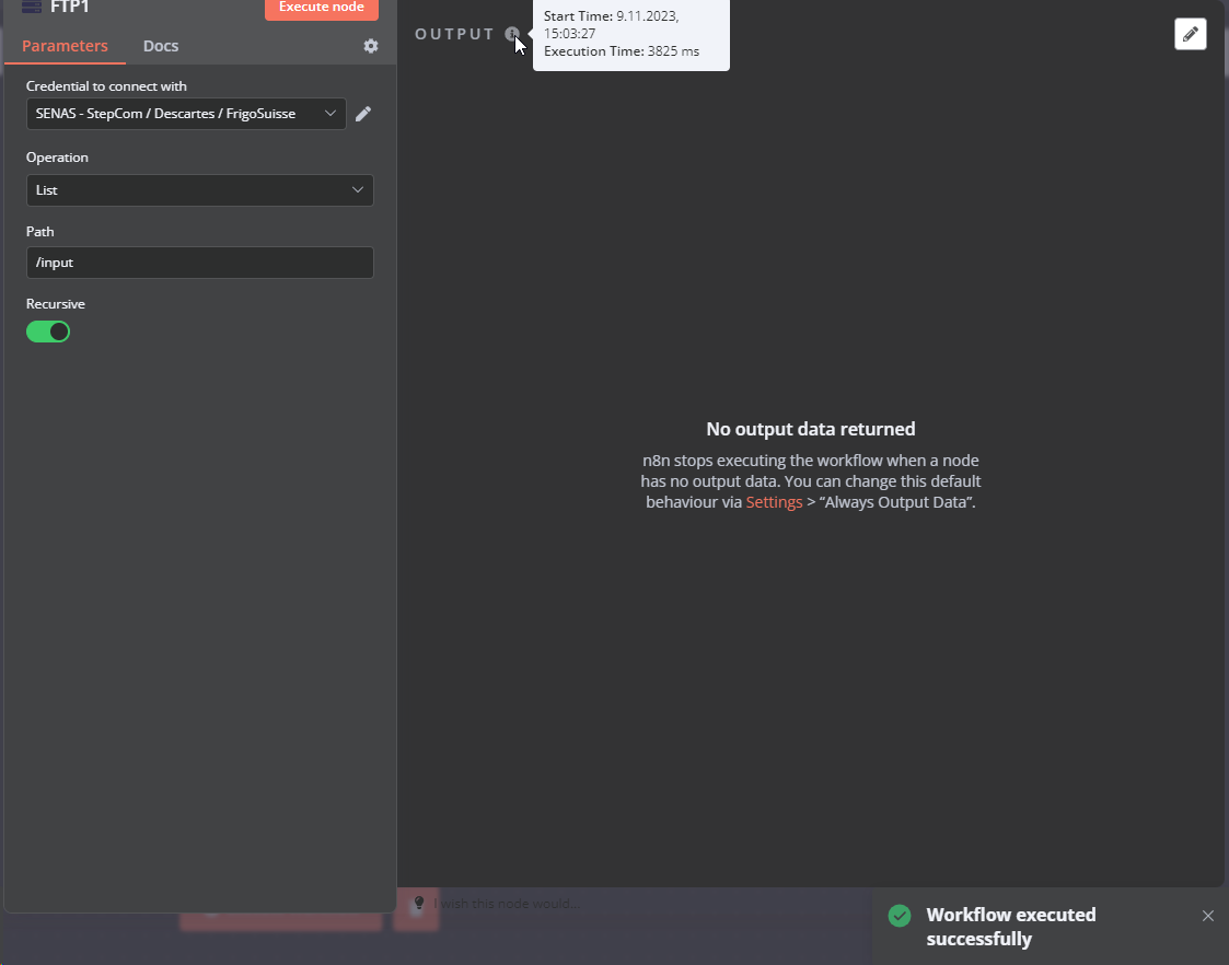

Hi @MutedJam
Thanks for your tries. Here the Workflow. Looks similar to yours. Nothing Special.
For the First run I get this:
And in the Second run immediatly this:
Do you need some more informations?

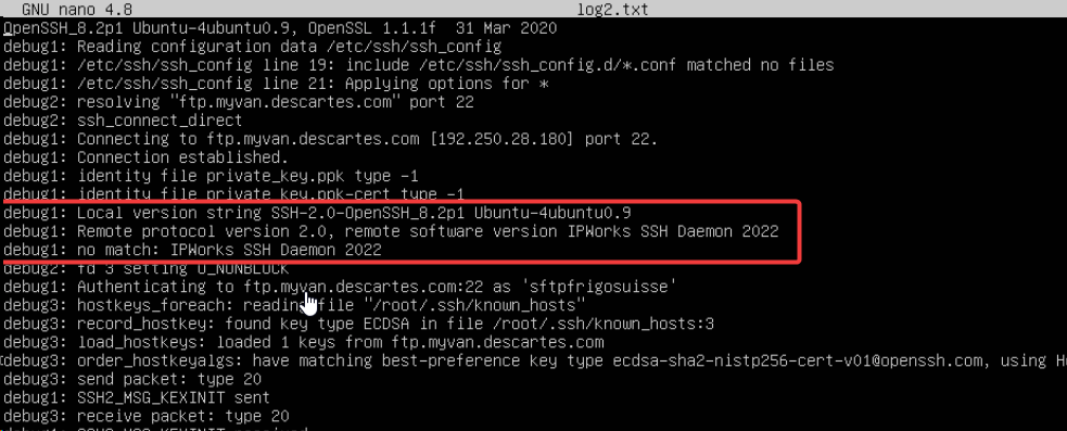

The software version would be handy, If you have SSH access you might be able to get that from the handshake as most servers output the version before hand. I know we have some issues with Windows OpenSSH services.
As soon I’m able to reconnect I’ll give you the output of the bash :slight_smile:
Finally: Found that:
Getting the same, if I connect via SSH (which I can’t successfully due to no access) or via SFTP. Same Protocol is clear but we will use Only the access for File transfer.

That is perfect, So I have done some testing against some other SFTP servers and we do close the connection so it could be that there is something special with the IPWorks implementation that may be similar to the Windows Server version that we need to work around.
