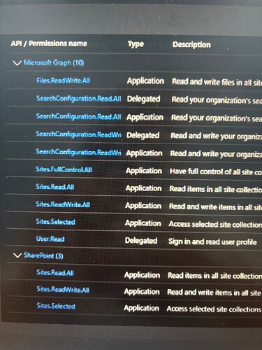

For reference these are the permissions i have added

I looked back at the app-only permissions I added. It wasn’t that extensive. The ones I noticed that weren’t in your list are Directory.Read.All and Sites.Read.All Maybe try adding those.

Okay thank you so much will look into it for sure
Hey, good news this solved the sharepoint error. Thank you so much.
