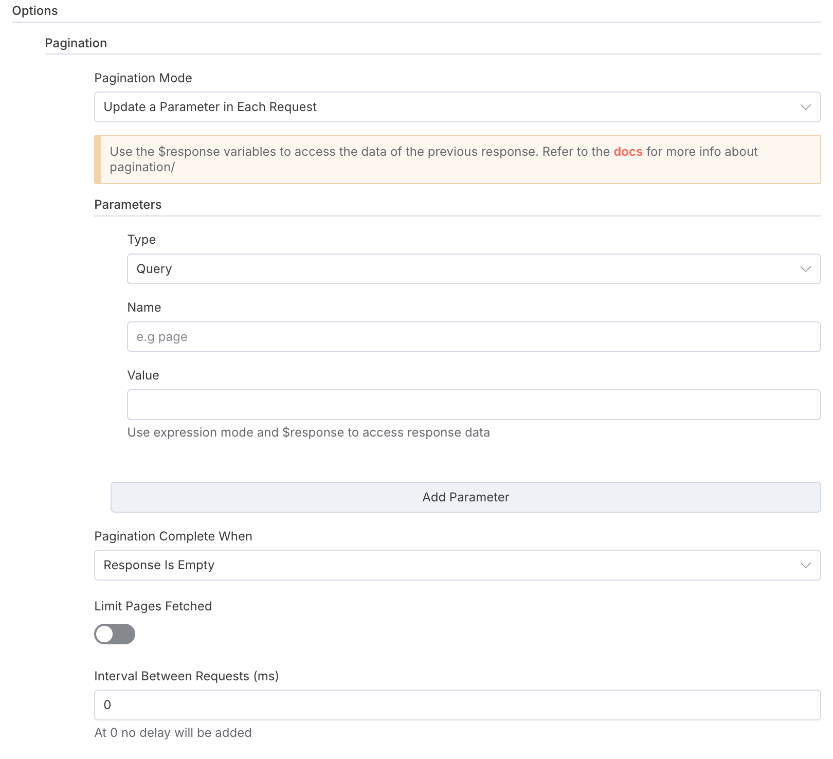

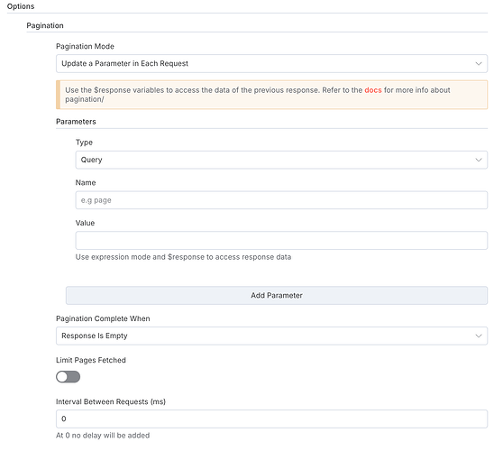

Did you try using the pagination feature in the HTTP Request node?
There’s a built-in option that allows you to configure pagination directly.
You can find more details in the official documentation:
