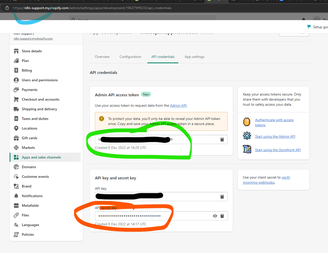

Hi @soulphforum, I signed up as a Shopify partner to get a development account and could authenticate using the Access Token method offered by n8n:
These are the values I have entered:
And this is where I got each value from:
I also had to “install” my app on the Overview tab of Shopify’s App Development page and have assigned a few scopes:
Perhaps you can give these steps a go and confirm if you’re still having trouble afterwards? This was my test workflow:
Damnit Muted You’re Awesome!!! You made me realize that my version was over 6 months old and needed an upgrade. Had to migrate servers to do so AWS locked me out for some dang reason. But I now see what you’re saying. If anyone else is having issues please make sure you have the latest version. Don’t be a numbnutz like me… lol
