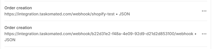

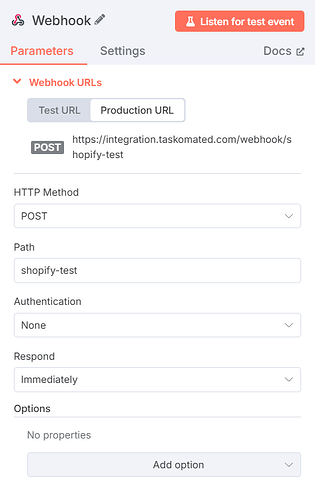

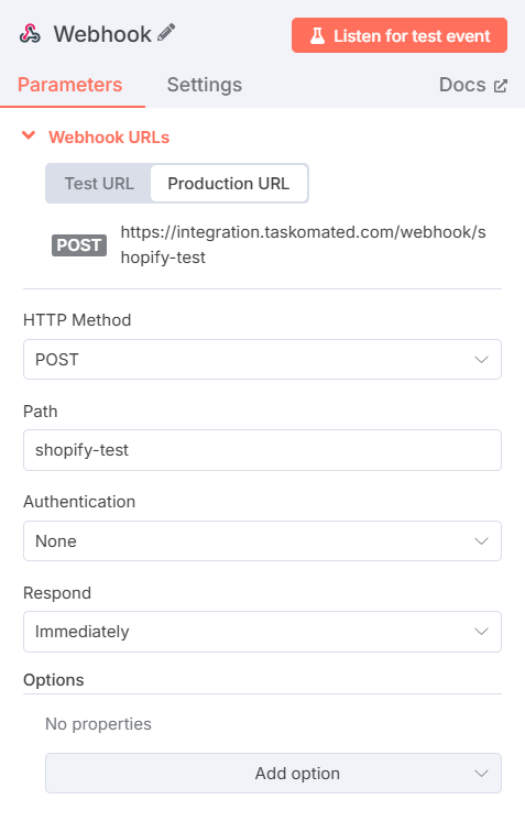

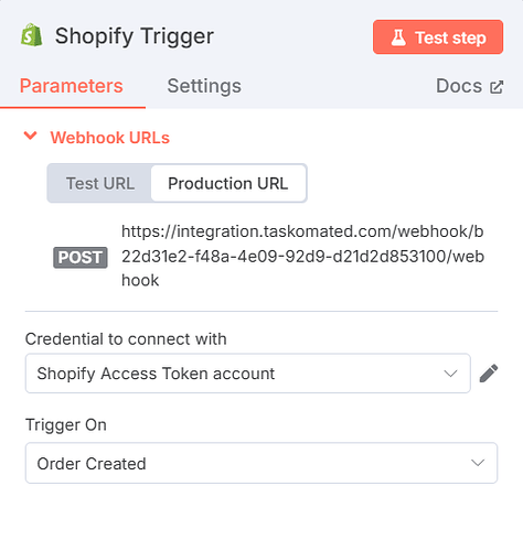

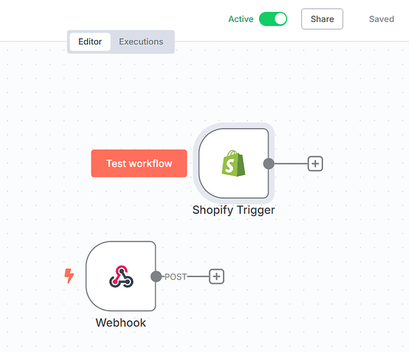

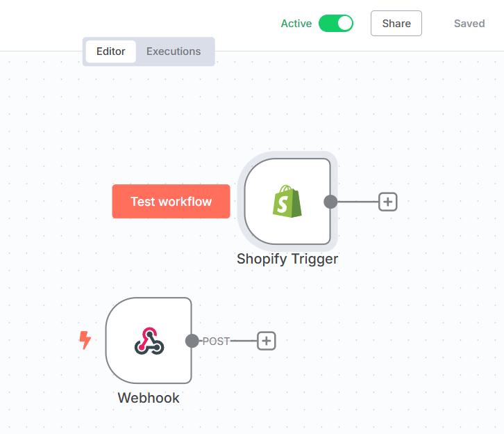

Thanks for your patience, but I still couldn’t get any output.
In Shopify Webhook setting:
Shopify Node:
Webhook Node:
Workflow status is active.
The URLs are all matched. However, neither node could capture the order creation event.
