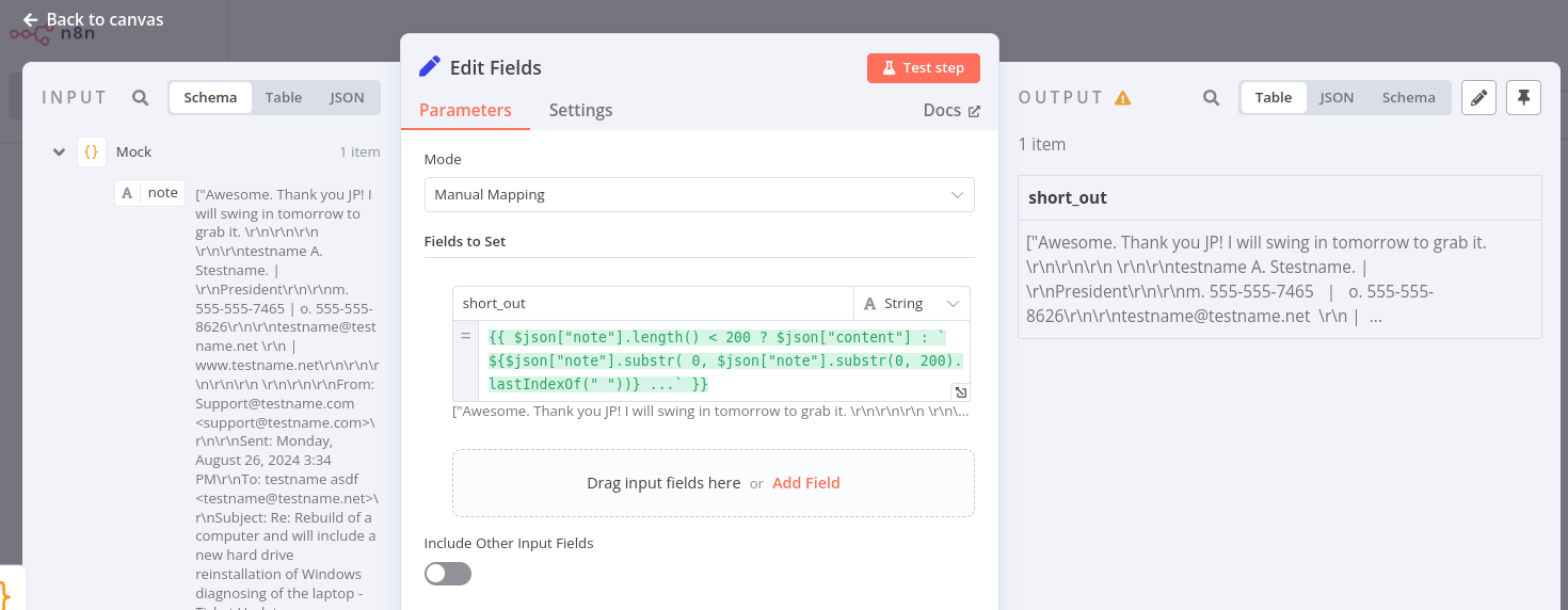

I have tried slices, substrings, and I am just stuck hitting a wall. Below is the mock data of the element I have plucked out and I want to transform. Please, can someone help me figure this out, it surely must be simple, because complex stuff I usually figure out… it’s the simple stuff that stumps me. :roll_eyes:

Maybe I am missing something but a simple slice should work here. I quickly updated your code node(love the name btw) to showcase it.
Hope this helps, let me know if there is anything more
Alternatively, you can do this in an expression:
Or, if you want to break on a word boundary only and add some ellipsis to indicate the string was truncated:

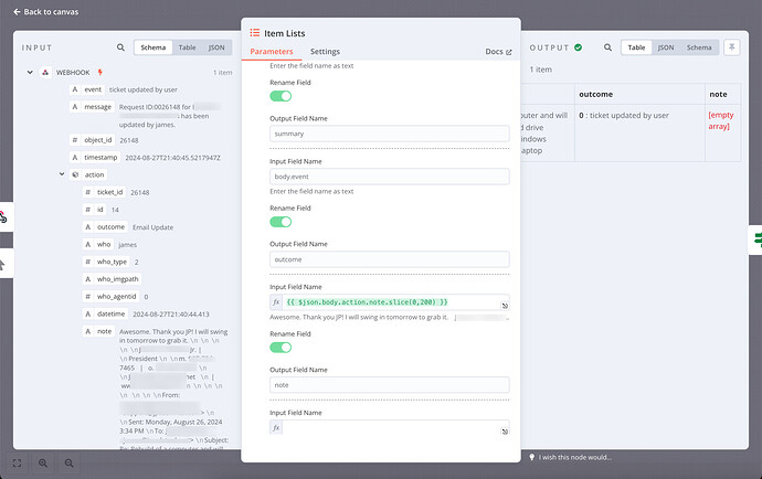

I tried the expression… and in the preview it looks good… but in practice it outputs an empty array. Perhaps I can’t use that in an Item Lists node?

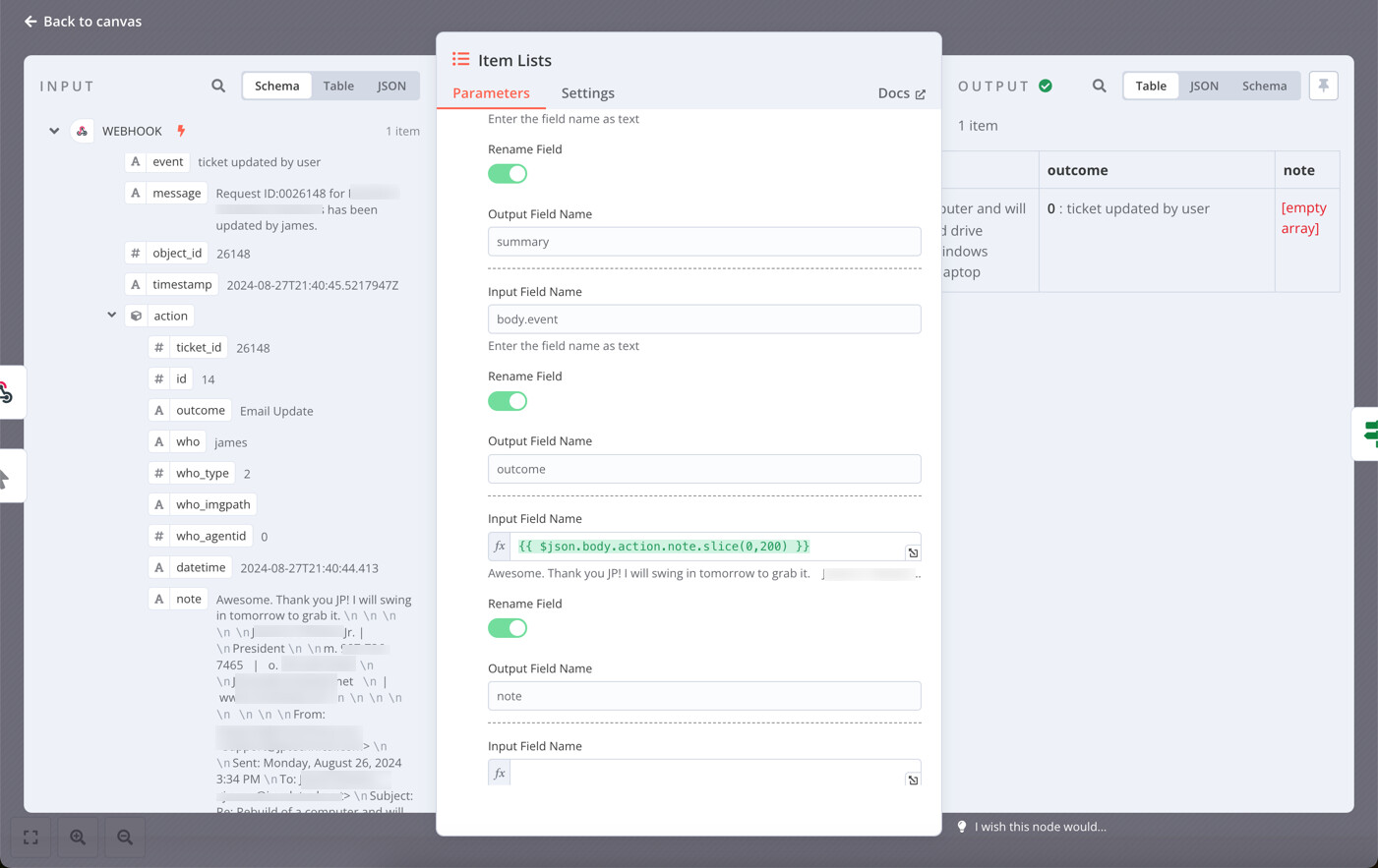

I even tried just putting the expression in the last step, where it creates the ending payload (google chat object). But it appears to just ignore the slice entirely.

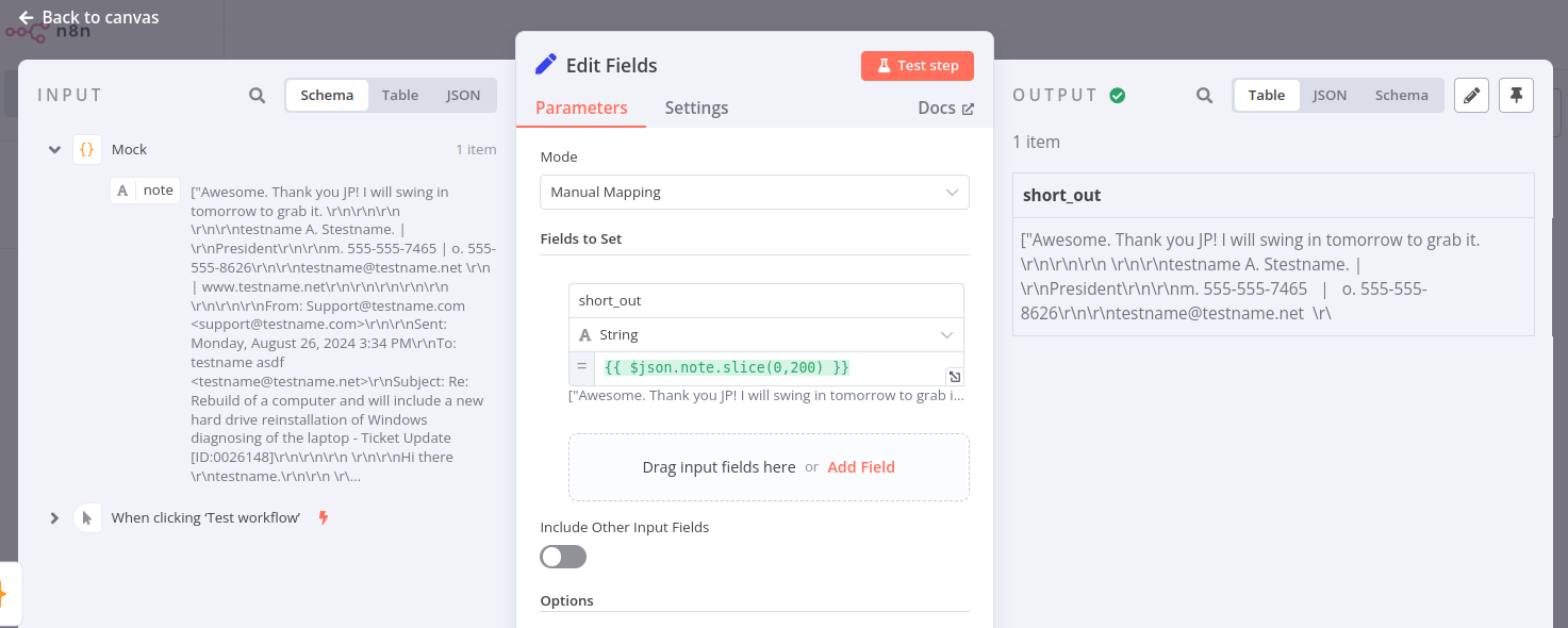

The secret sauce seems to be selecting the element with [0], so the working expression is {{ $json.note[0].slice(0,200) }} in the last stage. This works.
The field ‘input field name’ should only contain the actual name of a field, not a value like this.
