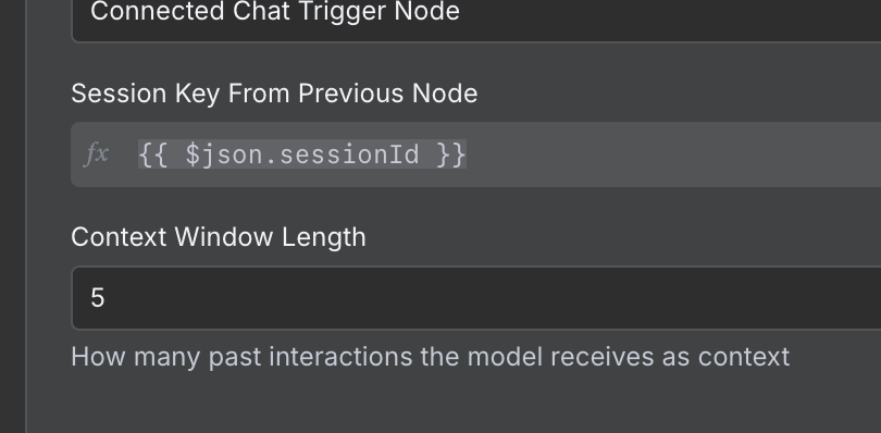

Yeah, using a static session ID for this use case. And it is persisted between runs because the flow generally works as expected.

I’m also using a static ID, and based on some tests, it seems that the simple memory retains data for around 30 minutes to an hour. I’m not entirely sure why this happens, but I hope this information is helpful.
