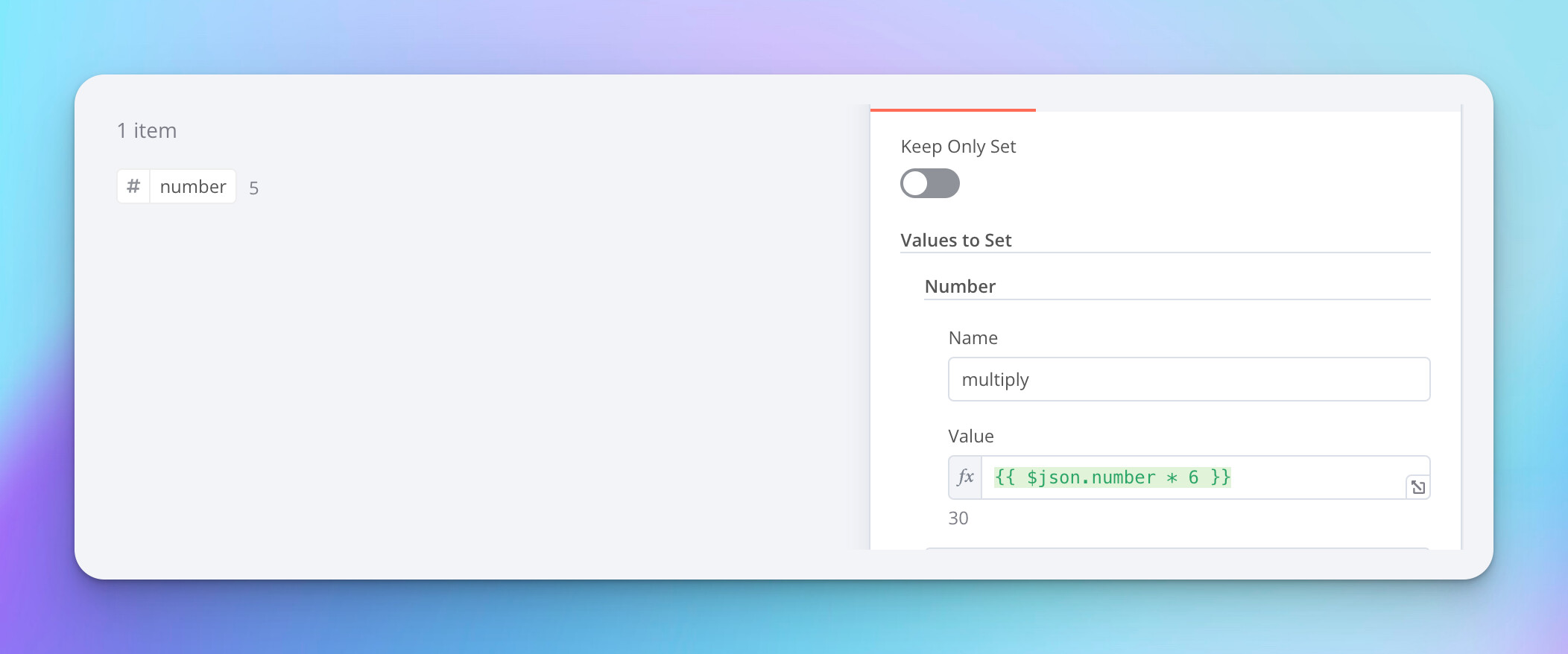

In your example, {{ $json.number * 6 }} is 30 . I need the number to be “30,00”. I normally append .toFloat().toFixed(2).replace(“.”,“,”), but I am unsure where to append this

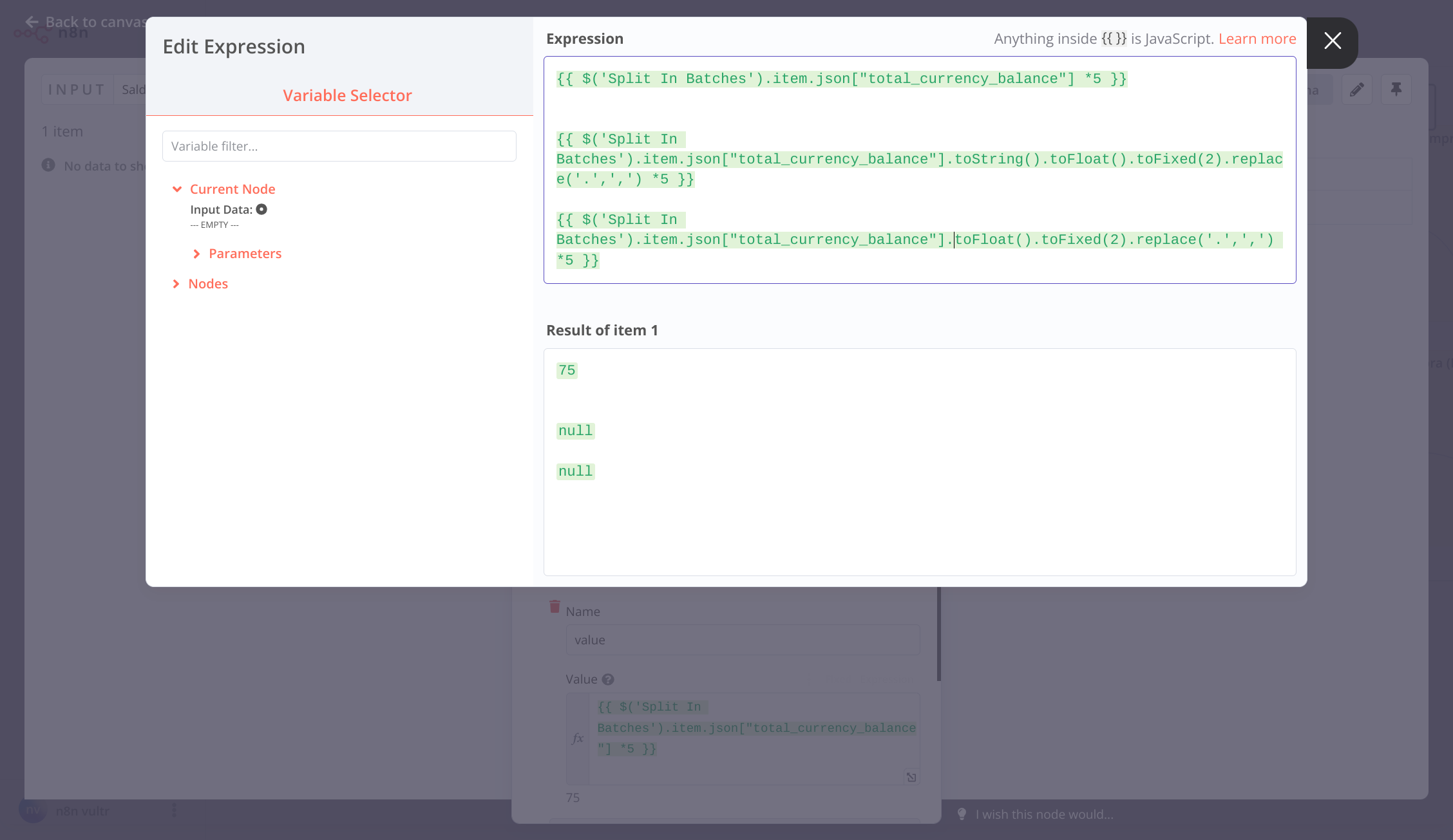

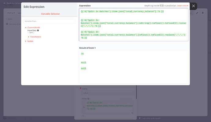

No problem, @fxholl - you could do this like this: {{ $json.number.toString().toFloat().toFixed(2).replace('.',',') }}. If you try to simply use .toFloat(), it’s only callable on a String
Ah, that would be because you’d need to do the calculation before you convert the integer over to a string You can then use the rest of the methods I mentioned after multiplying to give you “75,00”, if that makes sense?

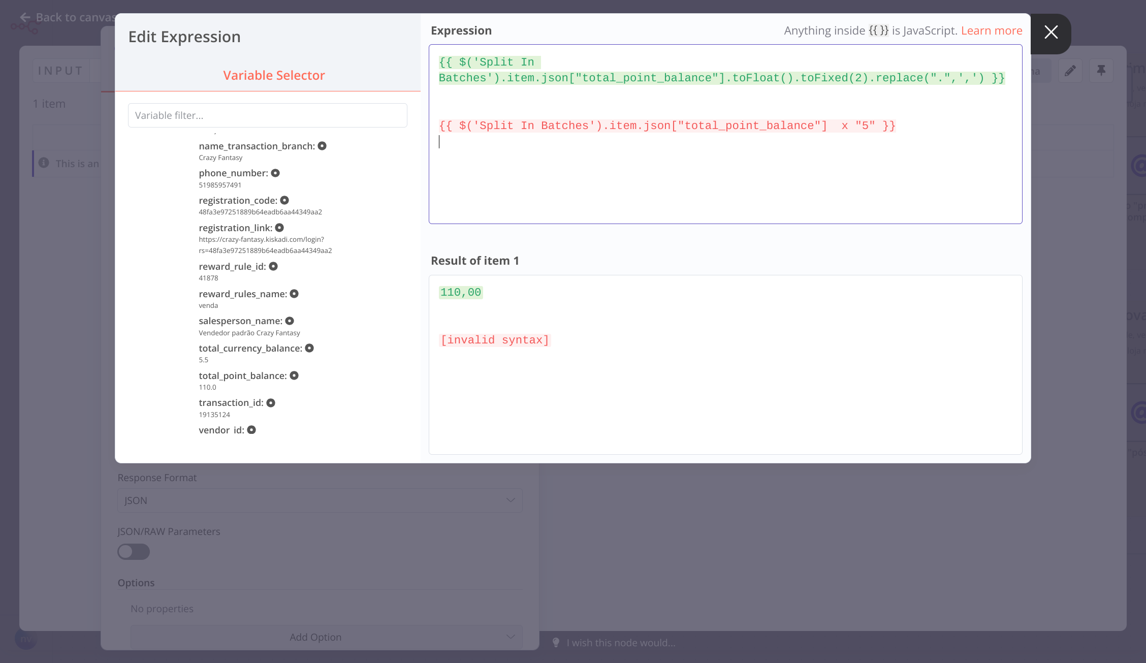

Yes, it makes sense. I guess my next question is whether there is a way to do that in the same node, ou or whether I need one node to get the min(a,b) and then another node to change the period to a comma.
I tried within the same node with no luck. If I have to use 2 nodes, I can figure out which ones (probably a Set node and then the HTTP node).
