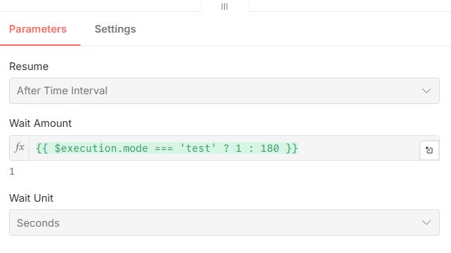

Since 2.16 nodes are stuck in waiting
I tried with 2.17.2 too, but now, many executions (even debug ones) get stuck on “Waiting nodes”.
They get stuck like this (says waiting in 1.03s, when 11:42 was 4 hours ago):
This is a HUGE bug, as it stops most workflows from ever completing.
I don’t know how waiting nodes are implemented, but it looks like it only checks once, and then it stops updating/checking.
It is indeed an issue with 2.16 and up.
I have reverted back to 2.14.2, and now all the waiting workflows/nodes got updated to this:
It’s either this (version change 2.16→2.14.2 ) or maybe simply the fact that the n8n service was restarted (?)

@XCS that negative execution time (-6719s) is a dead giveaway — the resume timestamp is getting calculated wrong, likely a timezone or clock drift issue between your DB and n8n process. check your GENERIC_TIMEZONE env var matches your system clock and DB server timezone, that expression on the Wait node evaluates at trigger time not resume time so a mismatch there would explain the stuck state exactly
