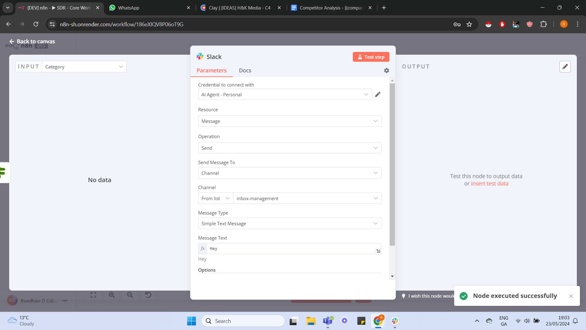

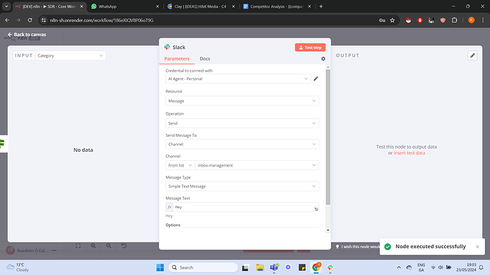

All of that is in place. I do not get any error messages, that’s the thing. After I press “Connect” when configuring a new connection, it just never saves. It says it’s saved, but when I try to click out of it it says “Close” or “Keep Editing” as if it was not connected. I’ve added every single bot permission. When I run this connection, it says “Run successful” but I get no output via the N8N side or the Slack side. Really confused haha
This is what I get when test running it:

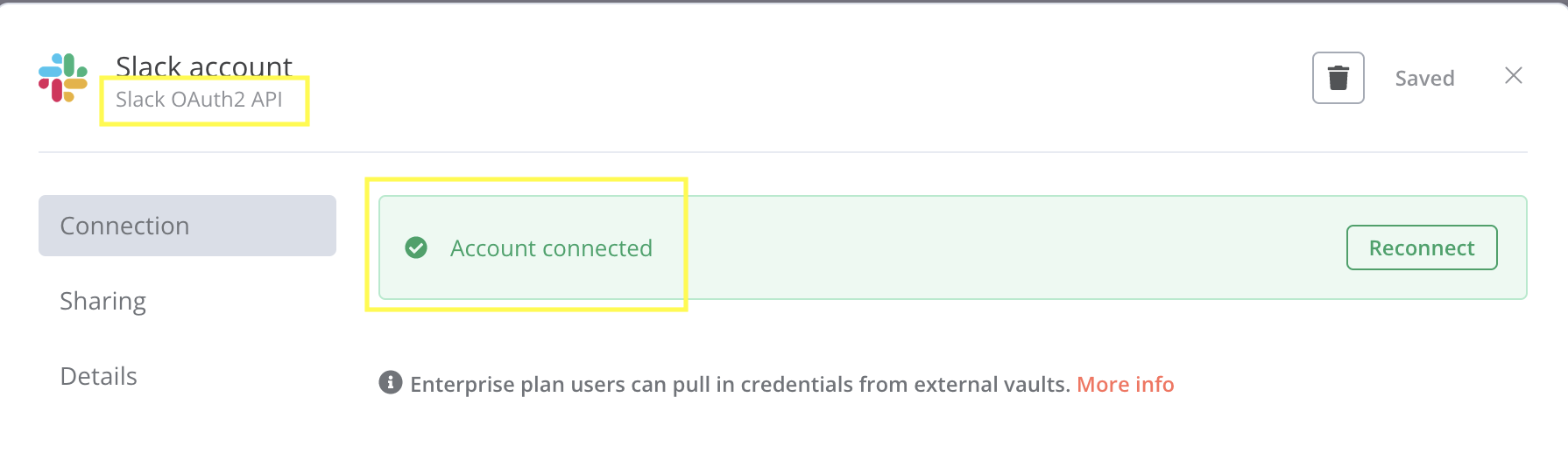

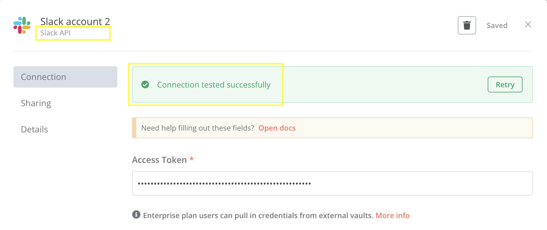

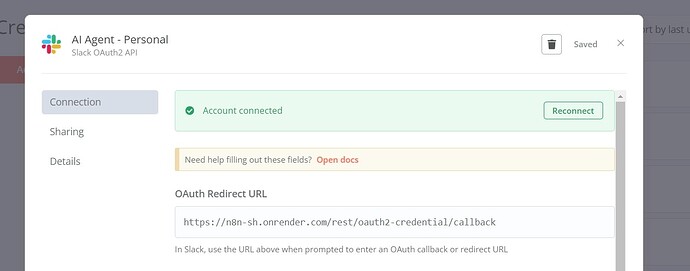

@ruadhan_oc , can you check the status of the connection from “Credentials” page? It sounds like establishing a connection between n8n and Slack has failed.
There are two types of authentication - via OAuth API and by means of the bot access token. Which one did you use? What is the status of the connection? Try to reconnect from “Credentials” page and let us know what you get.
Here’s how successful connection looks like for both types of authentication.
OAuth authentication
Token authentication
I’ve tried both types of connections several times, and it seems to be connected from the credentials page:

Can you share your workflow and n8n configuration? I have not been able to reproduce this myself so I suspect there could be a configuration issue somewhere, It looks like the node is able to load the channel list so things are working it is just something odd with the post.

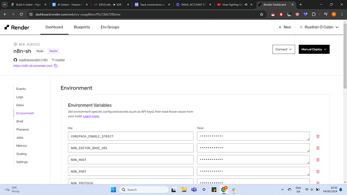

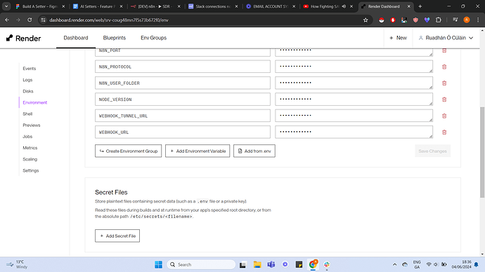

N8N Configuration:
Not exactly sure what to include here, but for context, I’m running N8N locally on a web service on Render (see all images below). I set this up following a YouTube tutorial titled “My New Favorite Automation Tool? - Get Started With n8n (Local Tutorial)” by “Mike Powers” (I can’t seem to send the link here).

You may also struggle to use n8n with those resources, I would recommend starting with at least 1 CPU and 1GB of memory.
