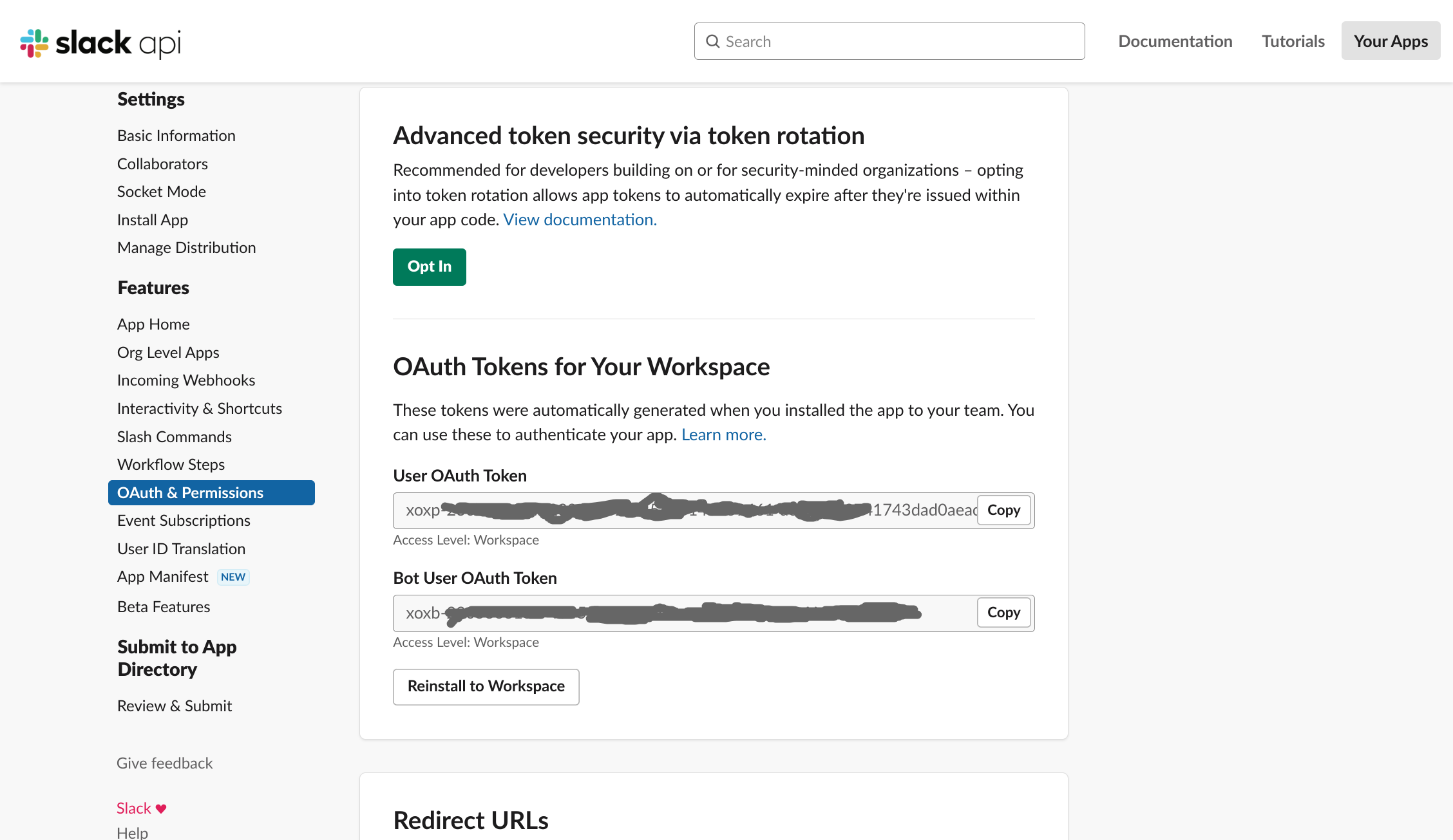

Hey @fxholl,
If you are using OAuth it will typically send as the user that authenticated, To send as a different user you would need to use a Bot token in the Access Token credential this will be something like xoxb_xxxyyyzzz.
On the Slack app side you will need to make sure that the bot user you create has permission to do what you want it to but the Slack App side of things is pretty good at telling you what each scope does.
I found a Bot User Oauth token starting with xoxb in Slack:
I added this token in Slack API credencials in n8n and it connects:

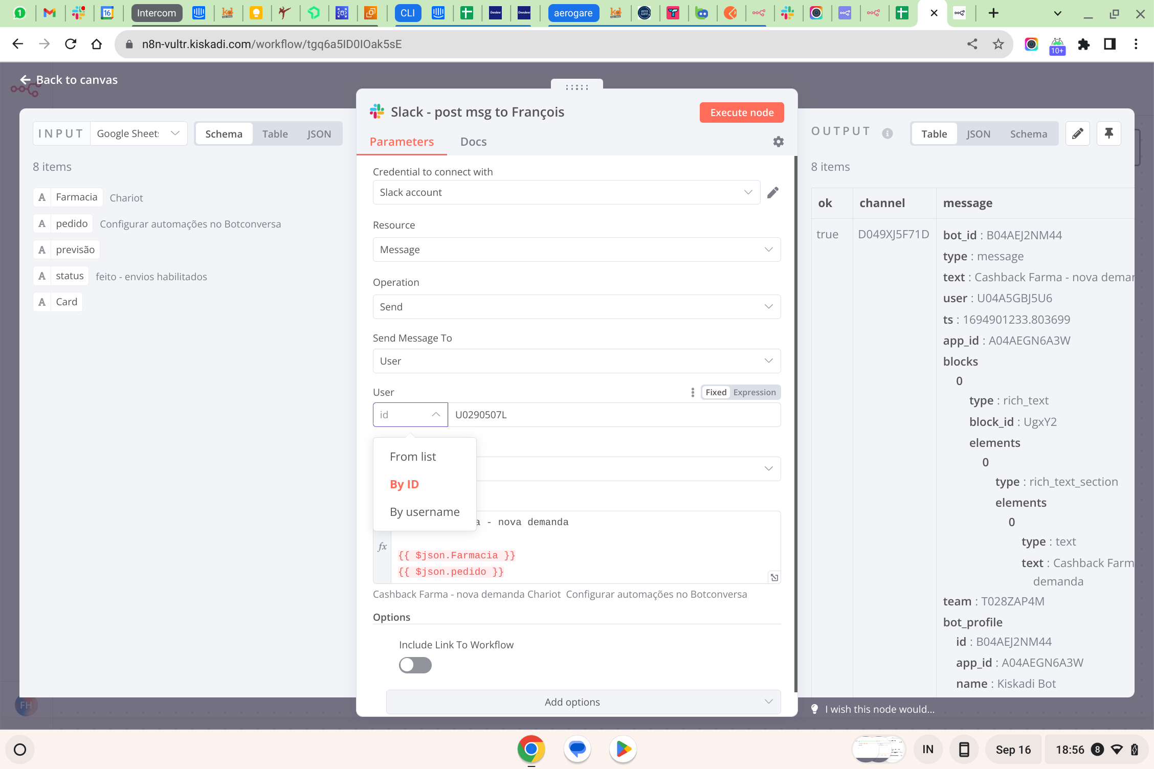

In the Slack node , when selecting the user that should receive the message, the option “from list” does not return the list of Slack users, but choosing by ID works.
@fxholl,
Perfect, So for a list of users your bot would need access to that scope as well, It looks like the scope would be users:read
thanks! I will try that and report back
