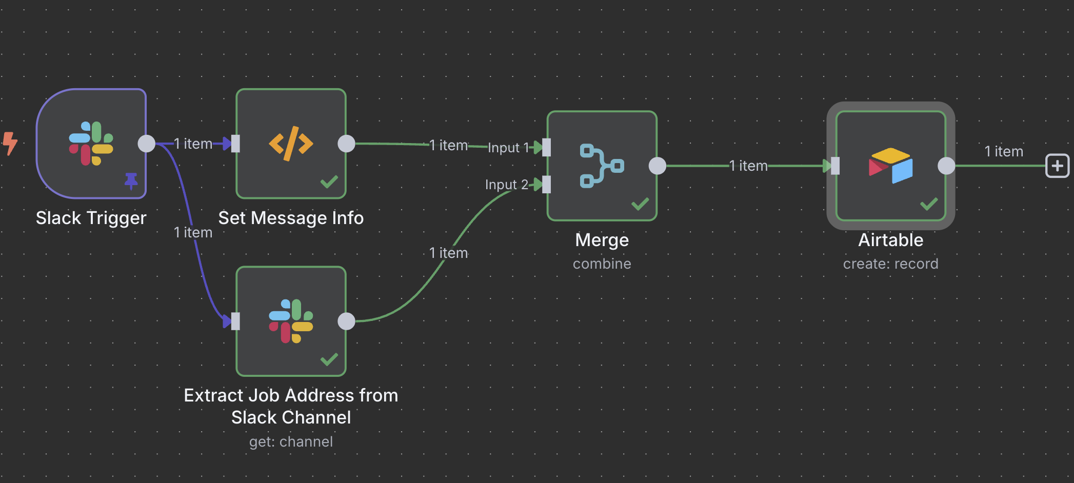

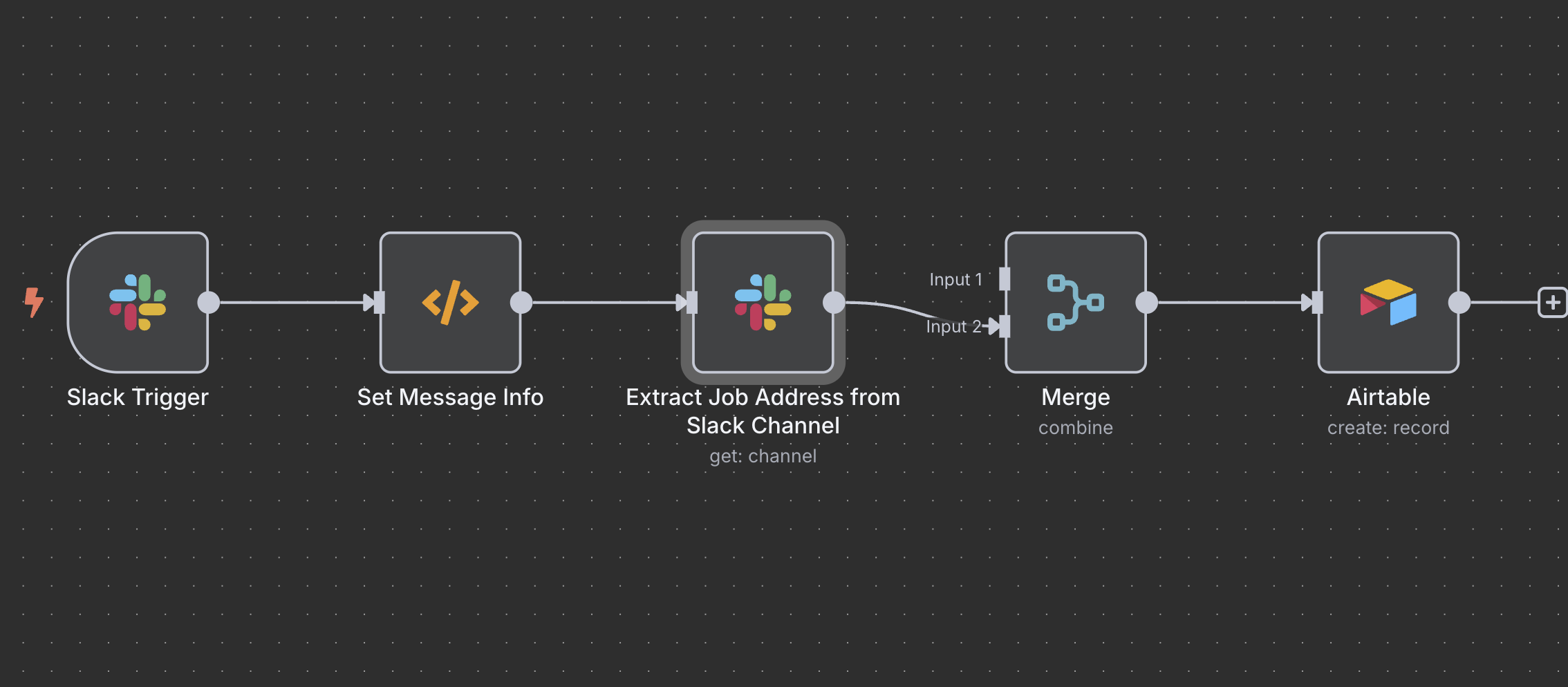

If this is your current workflow
You might need to change to like this one

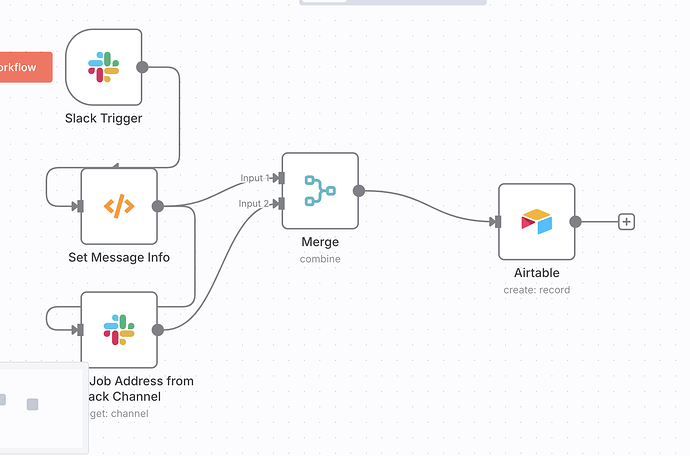

When you use merge you need to give path and data about what to merge.
You can seperate it at the front side.
This is what my workflow looks like. I am so new to this, I guess I should try to do what you’ve suggested? Scared to mess it up (albeit it’s already messed up).
YOU ARE JOKING. I did this, it took one second, and it worked. You are my savior. I’ve spent probably 12 hours using chat gpt to troubleshoot this. I know, silly, but I’m just a mom who works after her baby is in bed trying to find a way to automate invoicing for our business. You have no idea the relief you’ve given me. I’m going to add back in the other fields I want to capture from slack/columns. Once I get that working I will see if I can figure out the QuickBooks invoicing integration so invoices are drafted in real time from slack messages sent by my team.
