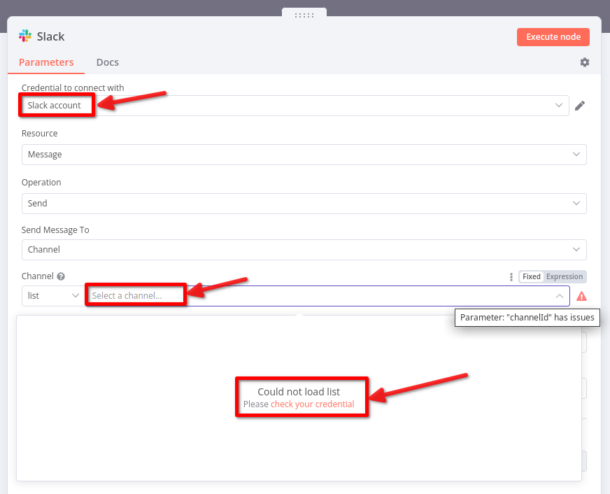

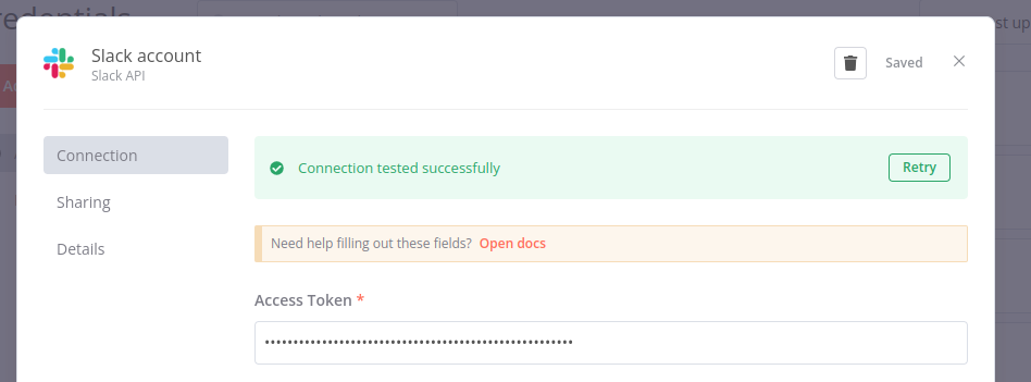

I created a Slack credential via Slack API, tested it, it works :
In my workflow in the Slack node, it cannot load the list of channels:
It says “Please check your credential”

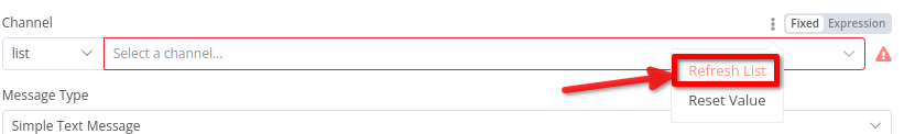

Are you using a bot or user token? It could be that you have not added the scopes to your Slack app so that would be the first thing I would check. You could also try clicking on the 3 dots next to Fixed above the channel box and select refresh to see if that shows anything.

I tried “Reinstall to Workspace” but didn’t fix the problem:
I tried “Refresh List” but didn’t fix the problem either:

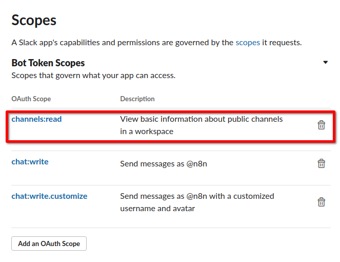

Hey @raphaelh,
The bot would need access to channels:read if you want it to read a list of channels, You may also need other scopes to be set depending on what you are doing.
hey @Jon
I added the channels:read scope :
Reinstalled to the workspace

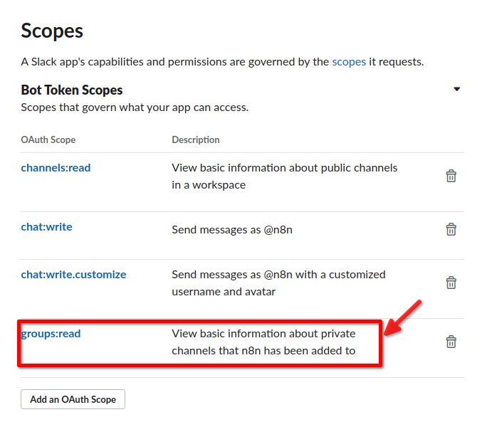

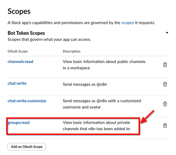

For those having the same problem, I had to add groups:read scope in addition to channels:read :
It’s for private channels
