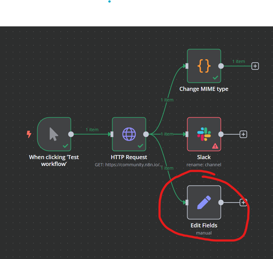

You can adjust your subworkflow to return data from the last executed node.
Subworkflows always return data from the last node executed.
The visual placement of nodes affects the execution order.
  • Nodes at the top execute first.
  • The last node executed is always at the bottom.
See the images below—nodes circled in red are the last executed in each scenario.
