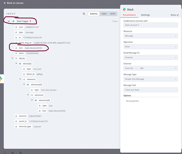

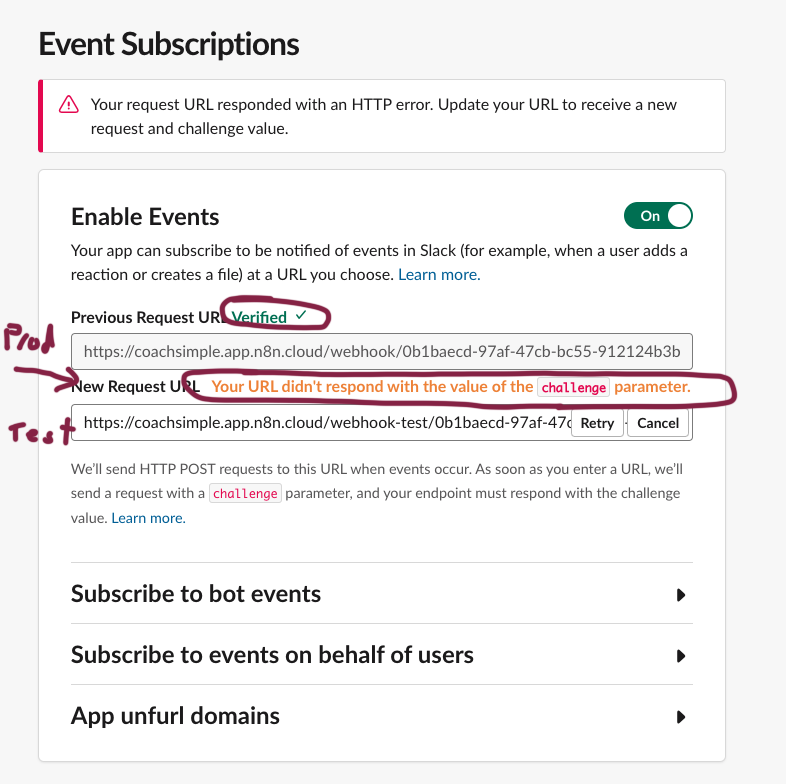

I am running into the same error message when trying to setup the Test environment. It verifies on Production webhook URL but the test one won’t work and therefore I can’t build my next steps as there is no test data to reference:
So if someone can further help me, I am trying to get a basic IF statement using the payload received in the Slack call
2 questions:
  1. How can I generate a test case using Slack when the slack app url won’t load for the test URL and in production I can’t see the test data in the editor
  2. What is the syntax to get the slack text value from the payload?
Here is the prod log payload:
Thanks for the help!
OK hopefully this helps someone else. I just figured it out after watching a YouTube Video. Here is what I was missing:

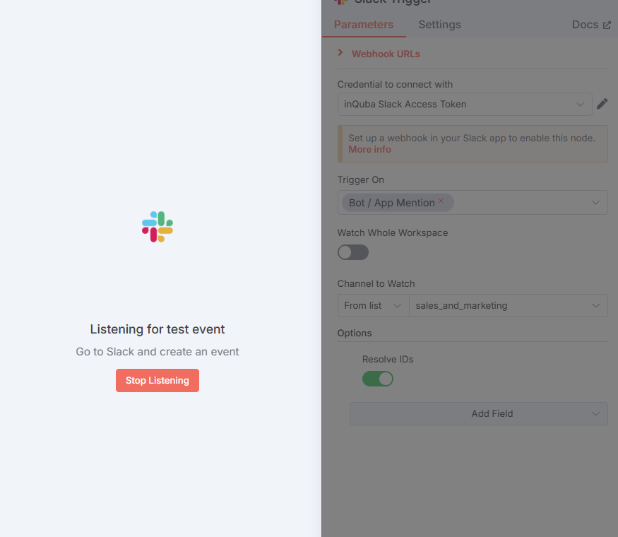

When adding the Test URL, FIRST, turn the trigger step to “testing” so it is listening for the test.
While it’s listening, then retry that webhook test URL and it works!
Then test your payload and finally revert back to the production webhook call when ready.
This was unclear to me by the online docs and threads above although I may have missed someone stating the same thing. Hope this helps the next person struggling with this.

For me, the key for resolving the challenge and response is to ensure that the flow is set into “active” and at that point cut and past the webhook URL in Slack while in “active” mode. To emphasise, it does not work when you use the “Listen for Test Event” I am using a hosted solution with docker (which does not appear to be the issue)
To get Test Mode working, go back to Slack and “Event Subscriptions” and cut and past the test URL. This has to be done while the worflow is in “Test Workflow” mode - this breaks production. It is thus lots of cut and paste
