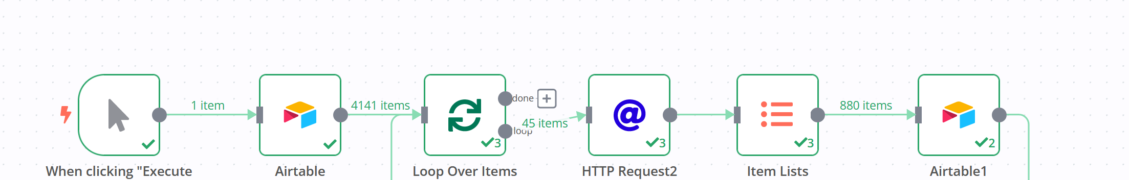

Im writing the data to airtable. But even when sending just a few requests it takes significantly longer on my self hosted instance.

I dont think this is a memory issue. I tried sending the exact same request as a test, sent 10 get requests and received around 10 mb of data. it took 2 seconds on the cloud instance and close to 9 seconds on my self hosted instance.
