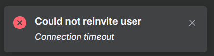

SMTP on DigitalOcean droplet not sending emails
SMTP on DigitalOcean droplet not sending emails.
Could not reinvite user.
Similar error for password resets, etc.
