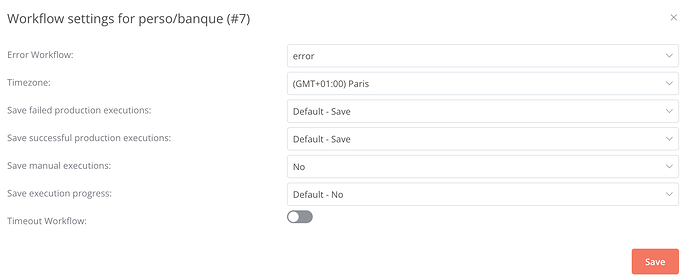

I remember adding an environment variable in my docker start command to set timezone to mine, but scheduled trigger seems properly configured regarding my timzone. I also checked timezone in workflow setting.

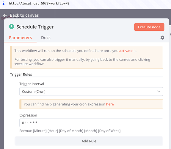

Have you tried using a ‘Custom’ cron syntax schedule just to test if it’s something strange with the ‘Trigger interval’ syntax style schedule ?
For me this is still executing at 09:30:00 daily, just double click on the icon below to see my syntax

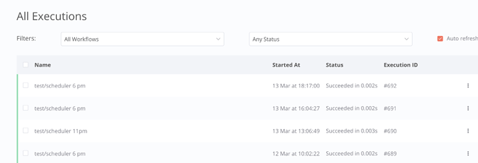

I did a few more tests :
Adding the TZ environment variable didn’t change anything.
I created 3 test workflows with just a trigger:

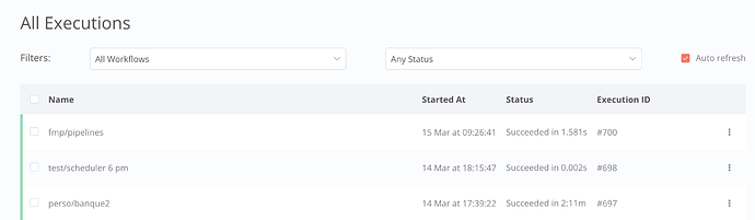

I am using my computer since 9AM with a pause and here is my execution log:
I am positive my macbook was not in sleep at 11am. And 11pm trigger triggeres at 1:06pm.
So I am wondering: when we set Days Between Triggers to 1 and Trigger at Hour to 11am, is it possible that if a timeslot is missed (because of sleep time), all next executions are shifted ?
