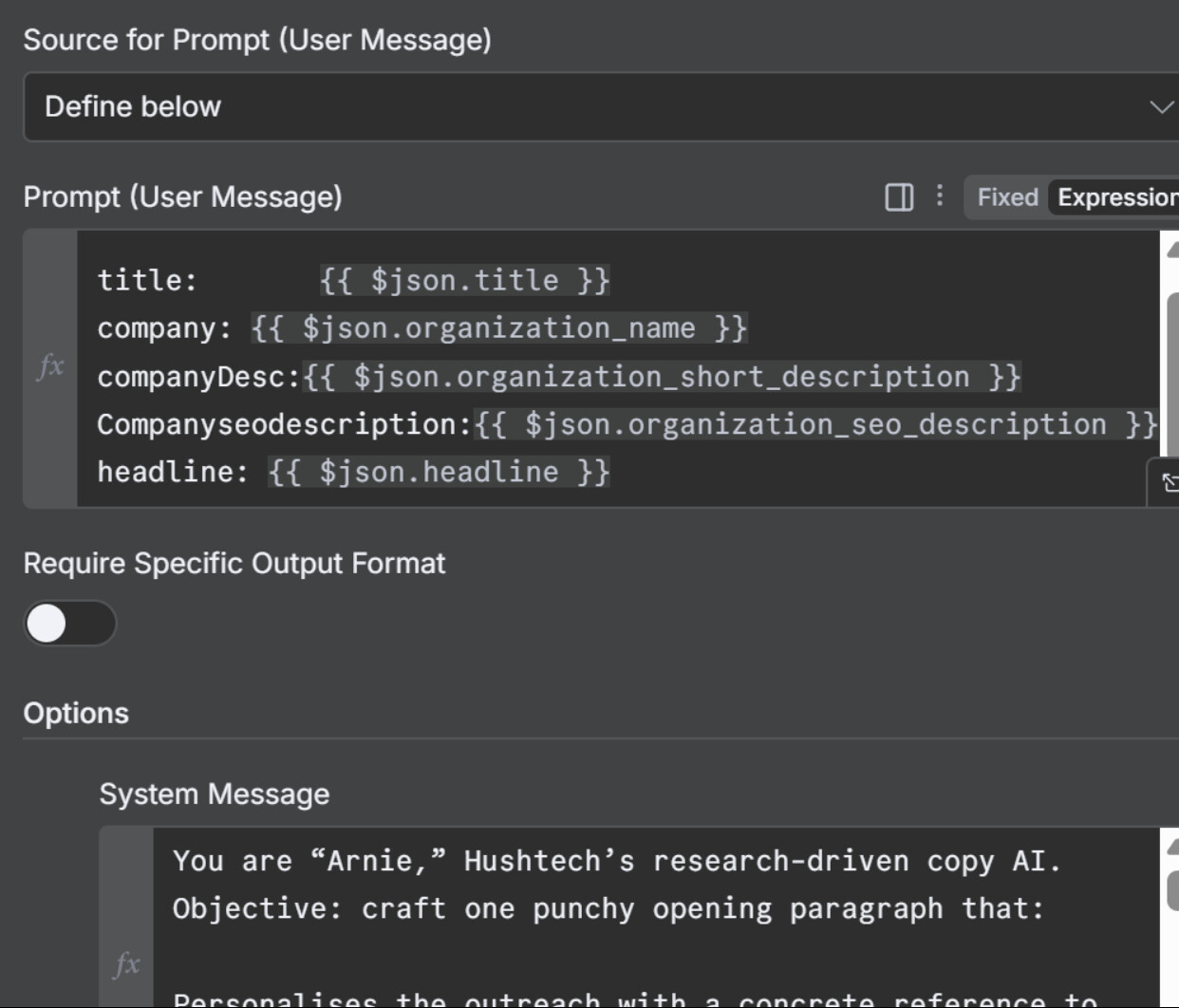

(Source for prompt) is frozen
Running a local instance for N8N. Running into the issue of this field being frozen. Any insight would be appreciated. Thanks in advance

Change the source from “Connected chat trigger” to “Define below” and put the input data there, similar to this usecase. So for your case its a research assistant, so define the input that is going into the ai agent.
