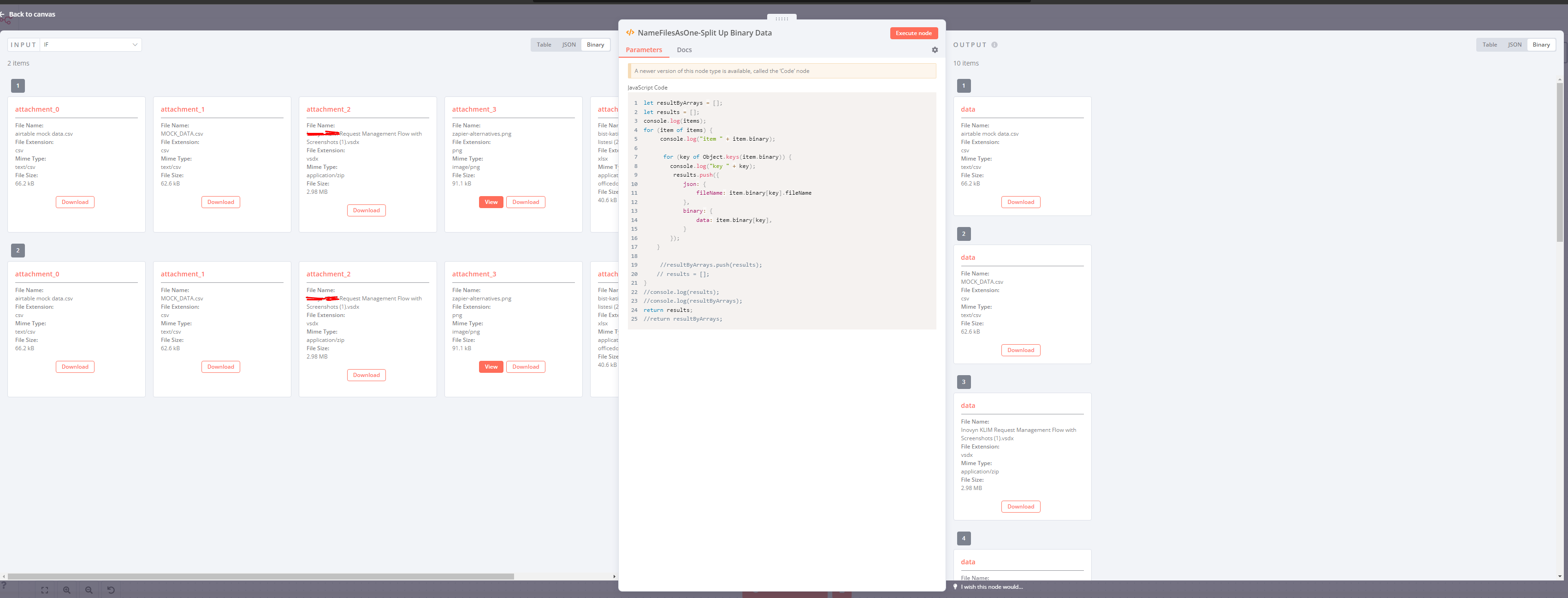

My code looks like this;
It just reveals all the files when there are multiple mails and files;
Merging multiple texts works but splitting the attachments into one name doesnt work for multiple files.
