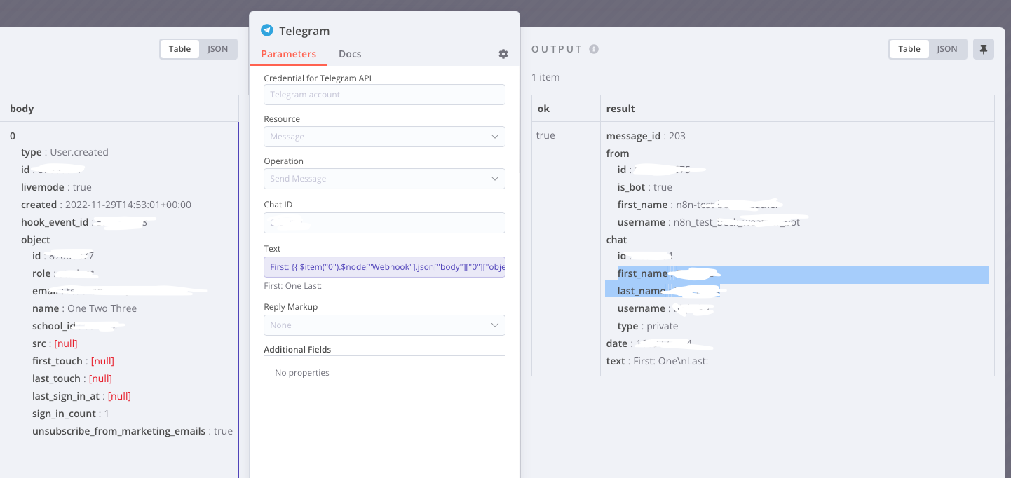

@seank1968 Many thanks, it sort of works now. As a test I am sending the below strings to my Telegram:
First: {{ $item("0").$node["Webhook"].json["body"]["0"]["object"]["name"] .split(" ")[0]}}
Last: {{ $item("0").$node["Webhook"].json["body"]["0"]["object"]["name"] .slice(1).join(" ")[1]}}
I am able to get the First Name, but the second part is empty.
@BramKn, Yes, I would want to get the first name in the FNAME and consequent names in the LNAME.
Any idea why .slice(1).join(" ")[1] would not work?

Attaching the screenshots of the workflow executions:

@BramKn & @seank1968 Thank you for your help!
The script you provided has solved my issue and this is what is working now:
It was self imposed issue that caused the problem: $item("0") I had typed ("1") instead of ("0")
The following script is working:
Last: {{ $item("0").$node["Webhook"].json["body"]["0"]["object"]["name"] .split(" ").slice(1).join(" ")}}
Here is the output:
