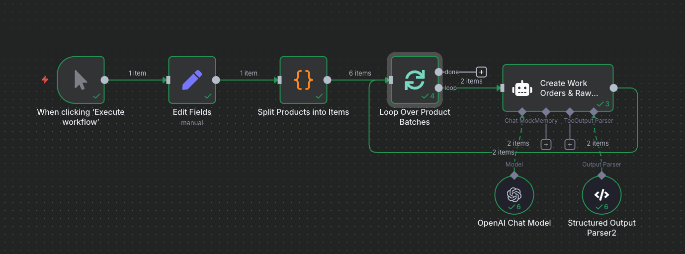

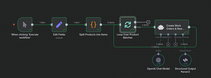

Here is the repro workflow I tried:
As you can see I took your reduced example above and lowered the batch size to 2. This means that there were 3 loop cycles, and the loop shows 4, which is correct - 3 for each iteration and one final one to come out of the Done leg.
If your AI Agent is receiving all data in the first run, the workflow will stop after it finishes processing those 6 items.
Instead of using a Code node, try the Split Items node and check if it works.
