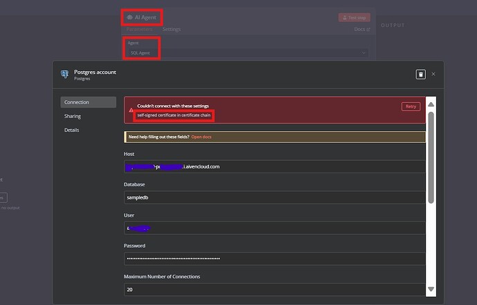

I am trying to connect my online PostgreSQL database (hosted on Avien.com) to n8n Cloud (version 1.80.5) using the SQL Agent node. The PostgreSQL database has SSL mode set to “require”, enforcing encrypted connections. However, when attempting to configure the connection in n8n, I encounter the following error:
Error Message:
self signed certificate in certificate chain
This error indicates that the PostgreSQL server is using a self-signed certificate (or a certificate signed by a custom CA), and n8n does not trust it by default.
Missing CA Certificate Configuration
While troubleshooting, I discovered that n8n’s PostgreSQL credentials form does not include an option to provide a CA certificate (CA token), which would allow n8n to properly verify the database’s SSL certificate. The PostgreSQL server on Avien.com generated a CA certificate, which I have, but I currently have no way to supply it to n8n via the standard credential form.
This lack of a CA certificate input is blocking the ability to establish a secure connection to the database.

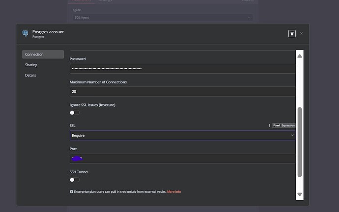

Ineffectiveness of “Ignore SSL Issues”
I also attempted to enable the “Ignore SSL Issues” option in the PostgreSQL credentials setup.
  • While this does allow the initial connection to succeed, it does not resolve the issue during actual execution.
  • At runtime, when the SQL Agent node is used in combination with an LLM (such as OpenAI, Claude, etc.), the error resurfaces and the workflow fails with the same self signed certificate in certificate chain error.
This confirms that ignoring SSL during setup does not fully bypass the problem, particularly in real-world agent executions.

I think custom CA is only available on self-hosted instances.
On n8n Cloud, you have no direct shell or file‐system access to drop in your own CA.
Other than using Let’s Encrypt directly, you could re‐issue your Postgres SSL certificate using a domain name that you control and Let’s Encrypt can sign it.
Then n8n Cloud will connect seamlessly in “Require” or “Verify” SSL mode without throwing the “self signed certificate in certificate chain” error.
