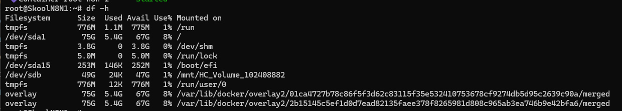

Anyway, when I was going around my server I saw two files/ folders that are huge 5GB each and it does not seem normal but I’ reluctant to just delete them.
The files under overlay
Perhaps someone knows if they are needed and if they are not needed, can suggest how to delete them and how to prevent something like that happening again?

Part of Docker’s OverlayFS storage driver, specifically used for managing the file system layers of containers.
  • merged/ is what the container sees as its full file system.
  • It’s created when the container starts and removed when it stops.
  • If a container is running, you can look in merged/ to inspect its full file system from the host.
Hey @Franz, thank you for the fast response.
After having an extensive conversation with Claude, here is what the AI told me.
‘’ I found that while df -h showed both overlay mounts as 5.4GB each, this was misleading - it was showing the total filesystem size available to Docker, not what each container actually uses.
When I inspected the containers using:
bash
Copy Code
docker inspect | grep -A 3 MergedDir
I could identify exactly which overlay directory belonged to which container. Then using du -h on those directories, I discovered my n8n container actually uses 1.1GB (mostly Node.js modules) and Traefik only 184MB.
The docker system df -v command revealed more details - my total Docker usage is 4.9GB, with 2.677GB in the n8n_data volume and 2.4GB in overlay2.
So those large overlay directories are completely normal and just part of how Docker’s storage works - as you said, they’re what the containers see as their filesystems.‘’
