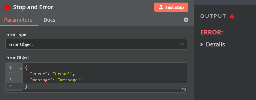

I’m using the Stop And Error node. Here’s the json that get inputed to the node:
    "refresh_token": "invalid_token",
    "error": {
      "message": "401 - "{\"summary\":\"Invalid token\",\"detail\":\"Token is invalid or expired\",\"status_code\":401}"",
      "name": "AxiosError",
      "stack": "AxiosError: Request failed with status code 401 at settle (/usr/local/lib/node_modules/n8n/node_modules/axios/lib/core/settle.js:19:12) at RedirectableRequest.handleResponse (/usr/local/lib/node_modules/n8n/node_modules/axios/lib/adapters/http.js:537:9) at RedirectableRequest.emit (node:events:529:35) at RedirectableRequest.emit (node:domain:489:12) at RedirectableRequest._processResponse (/usr/local/lib/node_modules/n8n/node_modules/follow-redirects/index.js:398:10) at ClientRequest.RedirectableRequest._onNativeResponse (/usr/local/lib/node_modules/n8n/node_modules/follow-redirects/index.js:91:12) at Object.onceWrapper (node:events:632:26) at ClientRequest.emit (node:events:517:28) at ClientRequest.emit (node:domain:489:12) at HTTPParser.parserOnIncomingClient (node:_http_client:700:27) at Axios.request (/usr/local/lib/node_modules/n8n/node_modules/axios/lib/core/Axios.js:45:41) at processTicksAndRejections (node:internal/process/task_queues:95:5) at requestFn (/usr/local/lib/node_modules/n8n/node_modules/n8n-core/dist/NodeExecuteFunctions.js:565:33) at proxyRequestToAxios (/usr/local/lib/node_modules/n8n/node_modules/n8n-core/dist/NodeExecuteFunctions.js:568:26) at Object.request (/usr/local/lib/node_modules/n8n/node_modules/n8n-core/dist/NodeExecuteFunctions.js:1957:50)",
      "code": "ERR_BAD_REQUEST",
      "status": 401
Unexpected token A in JSON at position 0
  • n8n version: 1.34.1 (but tried with previous versions with the same error)
  • Database (default: SQLite): sqlite
  • Operating system: NixOS
