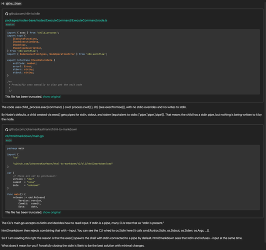

Every time I am trying to send the response, the forum blocks me, I guess something in the response triggers it, here is a screenshot of my answer :man_facepalming:
Thank you very much @jabbson for a thorough explanation; very helpful!
