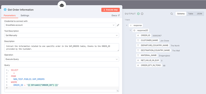

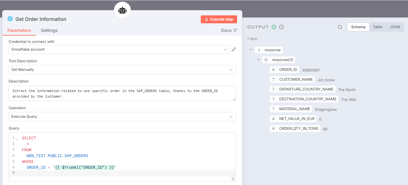

I have trouble understanding how I can parse the information sent back by the “Snowflake - Execute Query” node.
The workflow I’ve built gets an order reference through the chat {{ $fromAI(“ORDER_ID”) }} and retrieves the corresponding information in a Snowflake table.

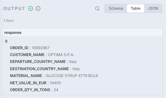

The output is displayed in “Schema” and “Table” format.
I know I can query these elements through {{ $fromAI(“CUSTOMER_NAME”) }}, etc., but I’d like to use a more deterministic option, like {{ $json.response.response[0].CUSTOMER_NAME }}.
What would be the best way to parse the response I get?

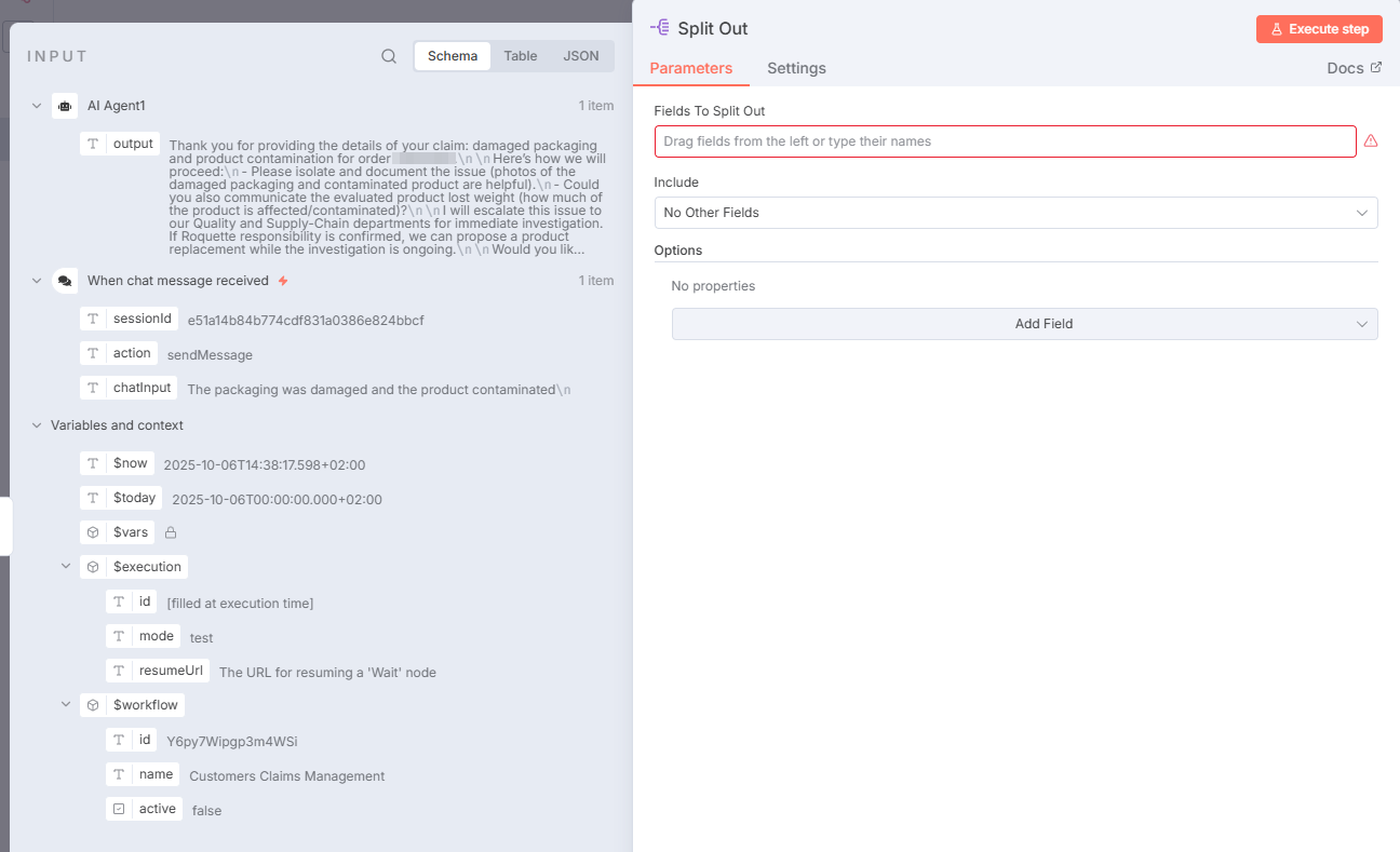

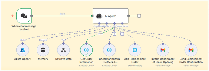

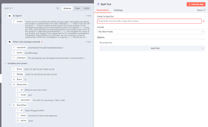

The thing is that the only place where I can add a “Split Out” node is as an output of the Agent:
But it only allows me to parse the AI or Chat info, not the one obtained through Snowflake tool :sad_but_relieved_face:
Is there a way to connect the “Split Out” node to the Snowflake tools so that I can get a structured output?

What you ask directly is :
But it seems is not yet possible?
And yes, the Agent node in n8n does have a **“Require Specific Output Format”** (not format output as i i mentioned earlier)toggle. When you enable this option, n8n prompts you to connect an output parser node, such as the **Structured Output Parser**, **Auto-fixing Output Parser**, or **Item List Output Parser**. This allows you to enforce a specific output format (like JSON) for the Agent’s response, making it easier to process the output in downstream nodes like Split Out. However, this formatting applies to the overall output of the Agent node, not directly to the raw output of individual tools used by the agent. You would need to ensure that the agent includes the tool’s output in its final structured response for further processing [Tools Agent node parameters]( Tools AI Agent node documentation | n8n Docs ) [Structured Output Parser common issues]( Structured Output Parser node common issues | n8n Docs ).
So, while the toggle helps you get structured output from the Agent, it does not give you direct access to the tool’s raw output—only what the Agent includes in its final response.
Thanks @Parintele_Damaskin ! So no actual solution so far :slight_smile:
