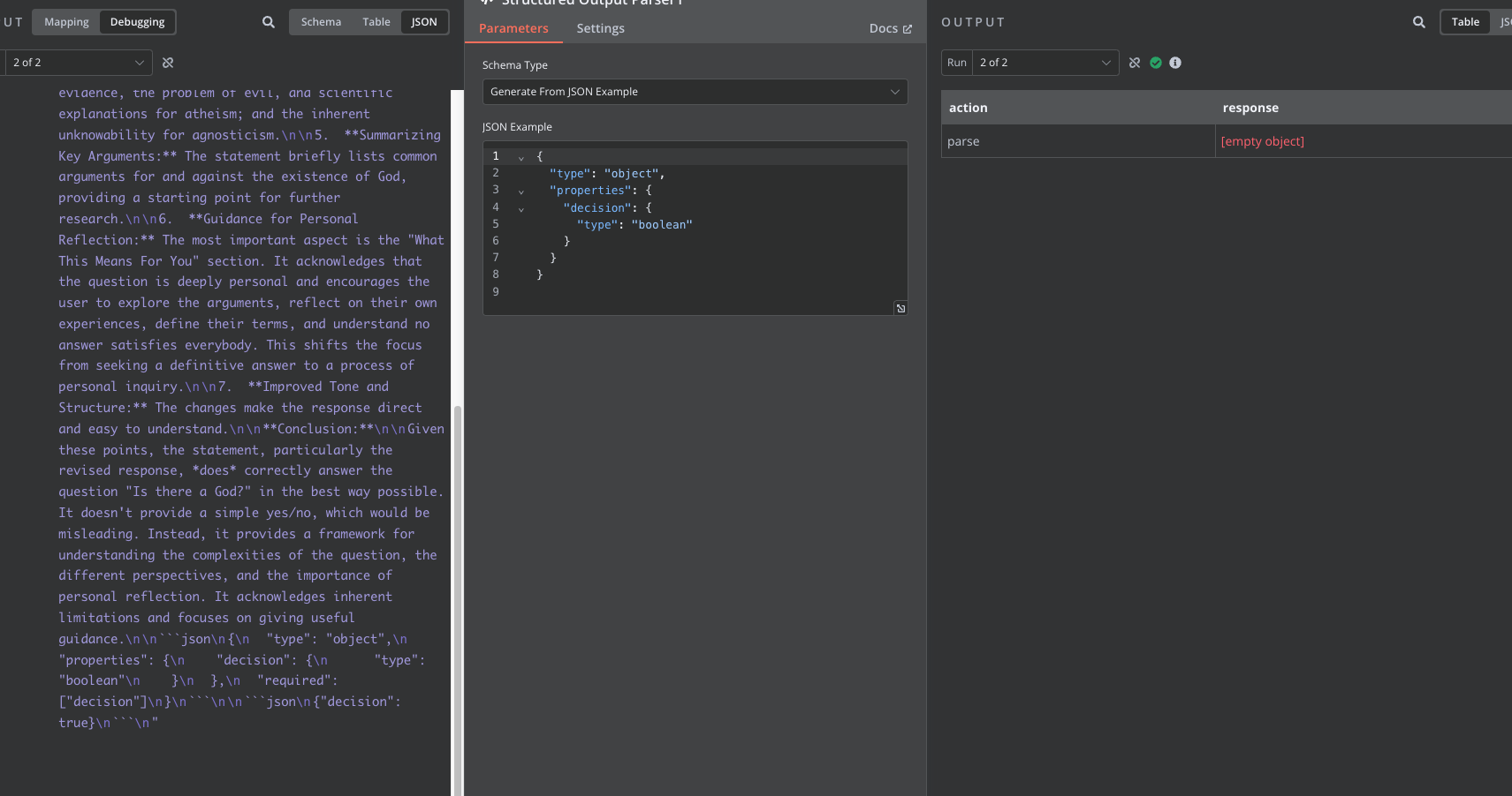

Structured output parser not parsing simple JSON
I have a simple WF, where I check for a very simple JSON expression. You can see the on the screenshot that the parser simply does not parse the output that the LLM clearly returns (bottom left). It always returns empty object.
None

using the latest cloud version
So I know the solution. I used LLM that did not have a tool support (Gemini 2.0 pro).
Hi @Vaclav_Soukup, great that you found out that you can use better models to give you proper output. I’d also urge you to look at the output parser: you entered a JSON schema, while the mode is set to “generate from JSON example”.
