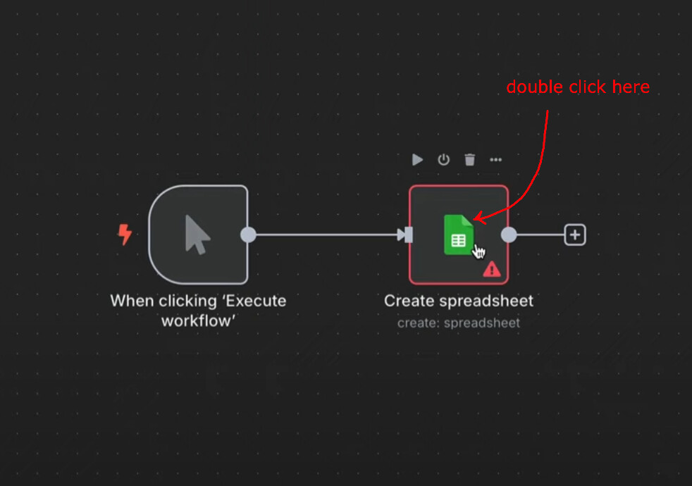

Right at 2:53, the screen goes black, there are 2 nodes. He then clicks on the Google Spreadsheet, and gets the control panel for it at 2:57.
He double clicks on the node Create Spreadsheet node:
Then clicks on the dropdown up top:
and chooses Create New Credentials.
Jabbson, Thank you from the bottom of my heart. For your patience, and superior instructions, and pictures! I am connected!
