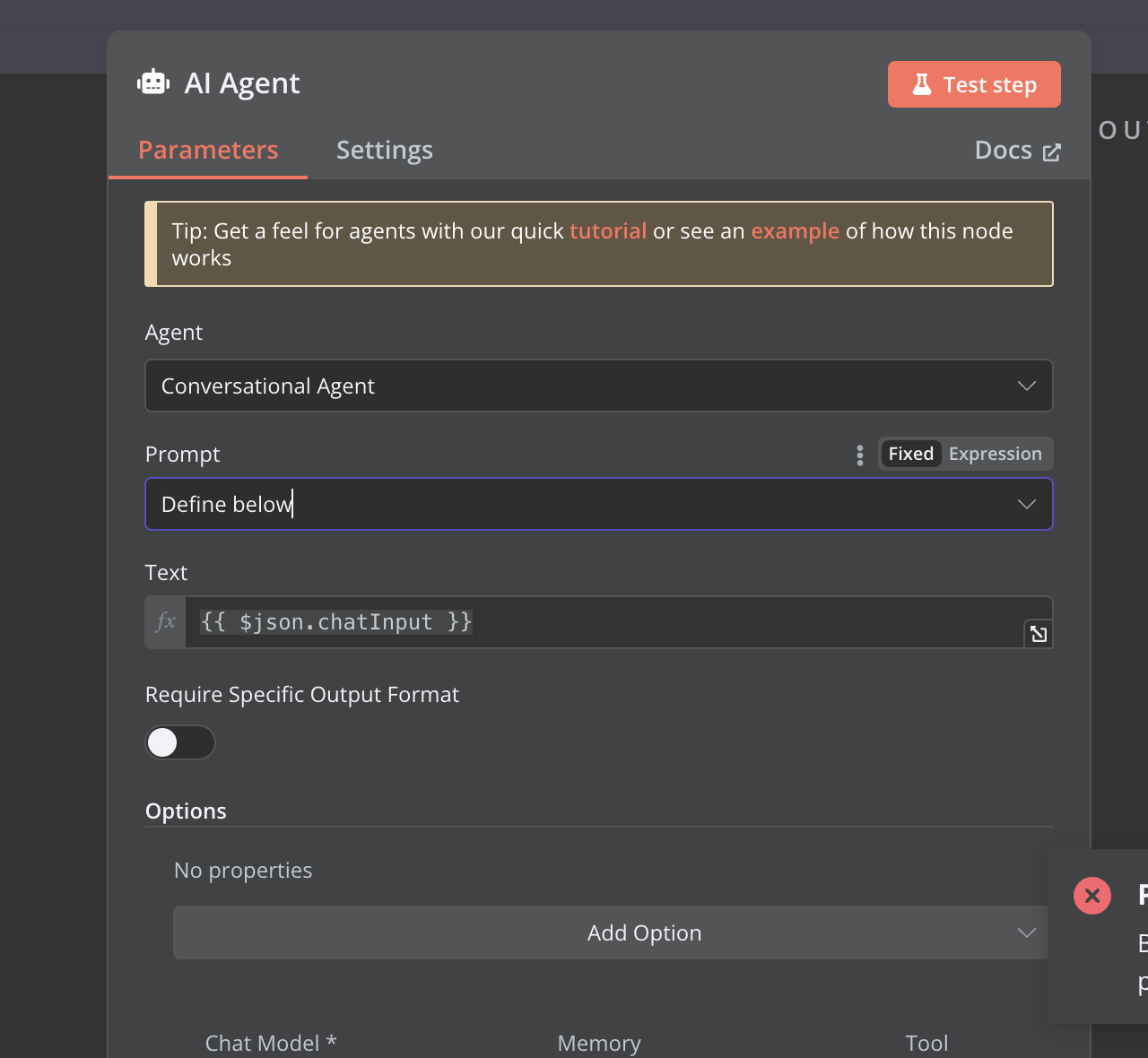

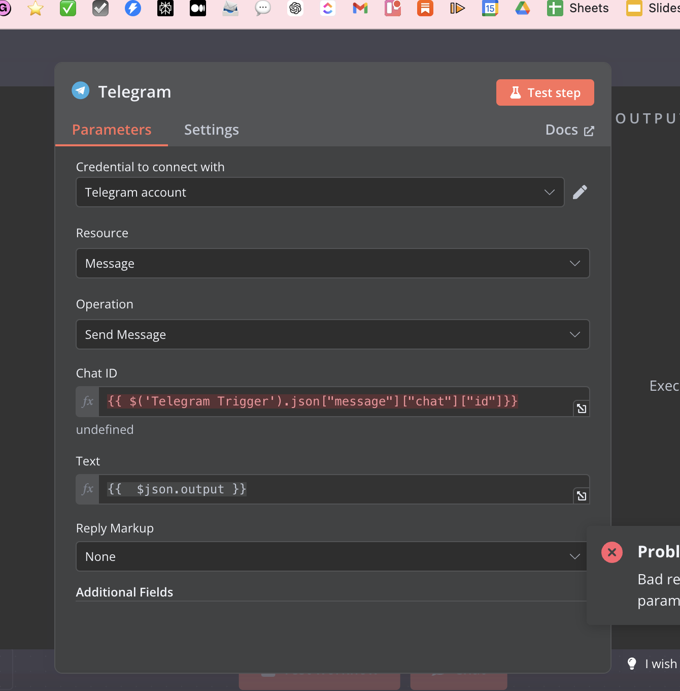

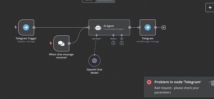

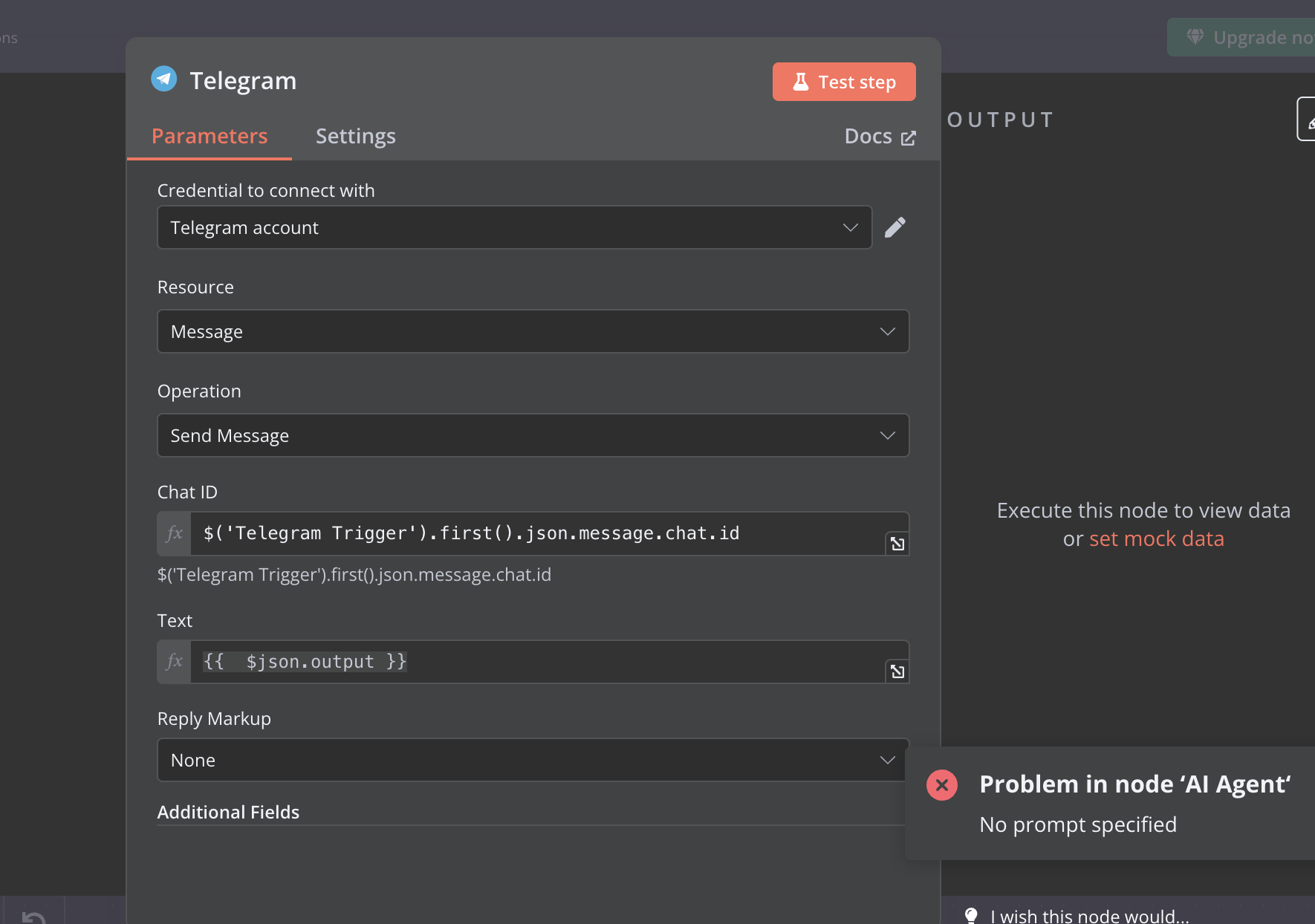

this is what i have so far

Looking at the error message the issue is in the last Telegram node and it is likely in the red expression, Before .json can you change it to .frst() so you have something like $('Telegram Trigger').first().json.message.chat.id and see if that works.

i’m trying to figure out how to navigate between this 2 nodes :frowning: unfortunately still stuck
Hey @rebbitkar,

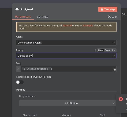

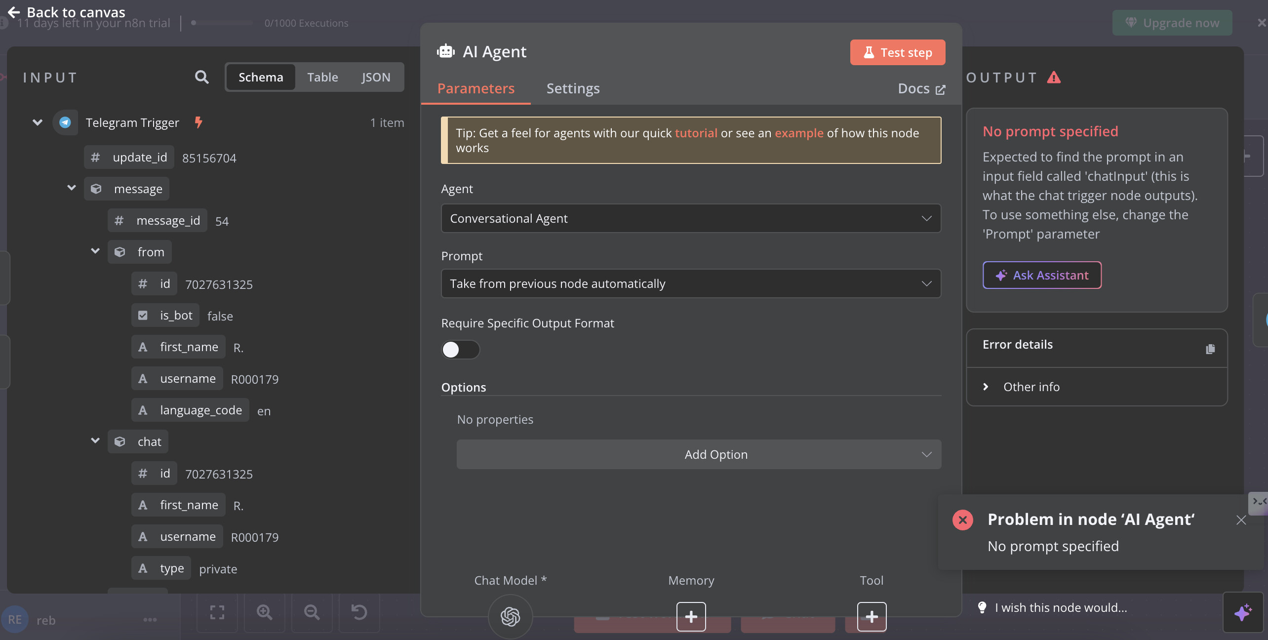

For the Chat ID as it is an expression don’t forget to use {{ }} around it. The AI agent also expects an input of chatInput so you may need to use an Edit Fields node to create this.
