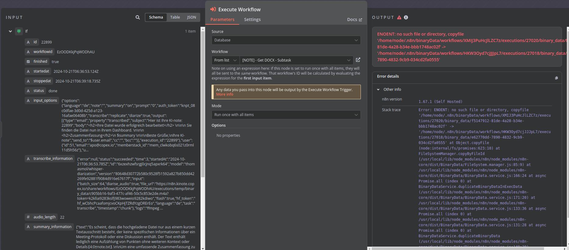

In that workflow I’m executing another workflow that only works if the SUB-Workflows setting for “Save successfull production executions” is set to “Save”. If the mode (Run Subtask - Create Docx) is switched to “Do not save” I get the error:
ENOENT: no such file or directory …

The error you’re getting is indicating a problem with some binary data processing in your subworkflow.

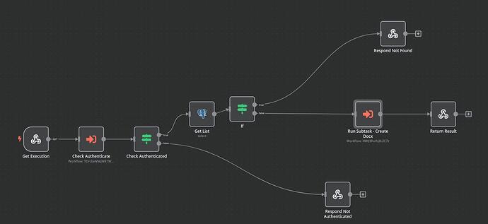

This is the workflow

looks like i configured my instance with an outdated verision of the documenation. Somehow I did not see that queue mode is not working with binary mode set to filesystem.
I think the problem is that if the worker is running on another host then filesystem won’t work that easy.
