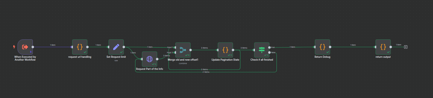

Thats my sub-workflow:
Hi, if you use the code function in the post it’s easier to see the workflow.
do you see a response in the executions when your workflow was executed as subworkflow?
Hi there!
thanks for your response. I got it working with remaking the Loop. I think n8n had problems telling where the end of my workflow is because of the 2 loops. With 1 loop it works
glad you solved it.
